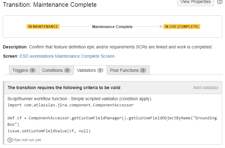

Hi,
I need to have the custom fields to be empty when I am closing the issue so that while closing the issue I can update the latest values in that custom field. The custom field is Text single line type.  I tried below code in validators, but getting an error. Kindly help.
import com.atlassian.jira.component.ComponentAccessor
def cf = ComponentAccessor.getCustomFieldManager().getCustomFieldObjectByName("Ground")
issue.setCustomFieldValue(cf, null)

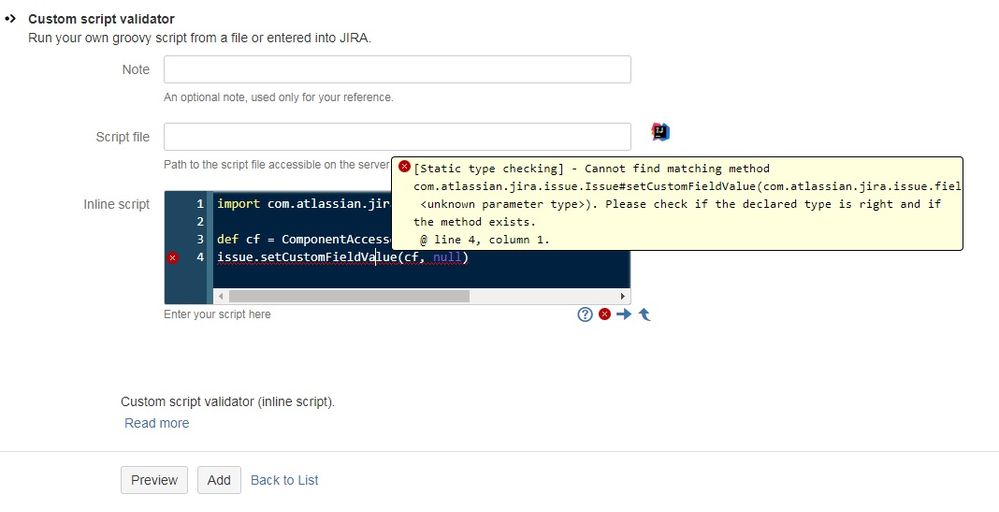

Marc Minten (EVS)
February 13, 2019
Hi, this is just static type checking, it is not a (blocking) error.It just says it does (can) not know the type of your cf variable (as you defined it by "def") and the null parameter. Nothing to worry about.
Save and your script will run (correctly).
