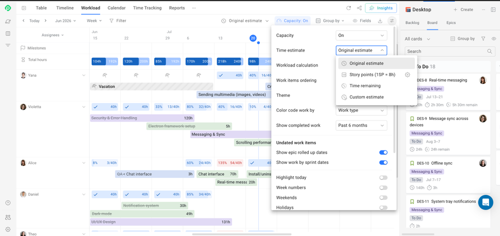

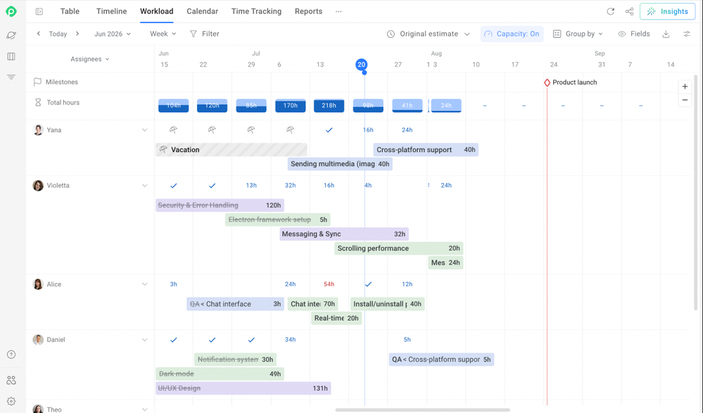

That’s where Planyway can help. It gives you a visual workload view on top of your Jira issues, so during sprint planning you can see each person’s available capacity, planned hours, and workload balance.
Workload is calculated based on set capacity, scheduled time, and estimation that can also be linked to Jira issues.
You can adjust assignments, move work around, and reschedule issues directly from the timeline while keeping everything synced with Jira.

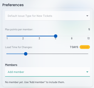

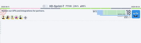

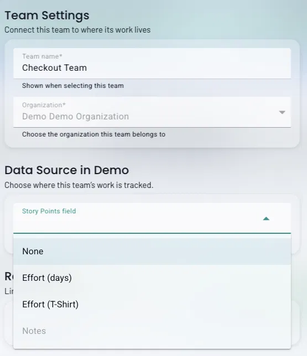

Since you asked specifically about hours: the effort field is set per team and takes any
numeric Jira field. Numbers pass through as-is, so if you map Original Estimate, the
workload, capacity, and per-person figures all read in hours rather than points.

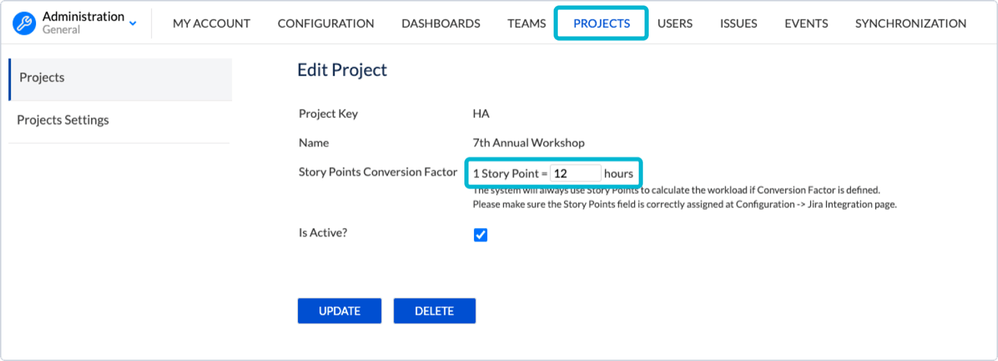

Where you're deliberately running two systems at once — story points on stories, a
time-boxed sprint underneath — you set the conversion once and the two axes reconcile.

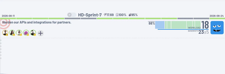

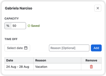

The part I'd argue for regardless of tooling: capacity only means something once
availability is in it. Marking three days off for one person here drops team bandwidth
23 → 22 and delivery confidence 88% → 84%, and the sprint's day bars show where the gap
falls. A sprint that looks overloaded is sometimes just someone's vacation.

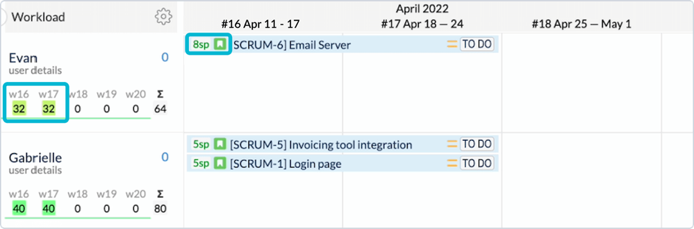

If you need a lightweight, visual and user-centric capacity planning (individual capacity planning) experience, you can try Sprint Capacity Planner for Jira developed by our team.
This app offers sprint capacity planning with an intuitive calendar interface. It enables you track user-level team availability, manage time-off and prevent over-commitment to deliver predictable sprints.
With this app, you can:
  • Choose between Story Points or Remaining Estimate depending on your team's workflow
  • Set working days and hours with story point-to-hour conversions
  • Manage time off (team-level and user-level)
  • View individual capacity per team member rather than relying on average team metrics
  • Easily drag work items across the Backlog, Active Sprint and Future Sprints.
    Place and reorder work items anywhere on the timeline calendar to define their precise execution sequence
  • Spot over-allocation instantly with color-coded capacity indicators (Green: Fully utilizing available capacity, Blue: Has remaining available capacity and Red: Over-allocated)
  • Instantly visualize your sprint status (On TrackBehind Plan or Ahead of Plan) while monitoring PlannedDone and Target metrics in real time

Hi @Antoaneta Iskra and welocme! This is a common setup, and it's basically what ActivityTimeline (a Jira app we build) is designed for.
  • Mixing story points and hours: Keep story points on your stories for velocity, hours on sub-tasks. AT lets you set a Story Point → Hours conversion factor (global or per-project) so both feed into the same workload calculation without changing how you estimate in Jira.
  • Per-person workload during sprint planning: Each person's available hours (capacity) are set individually and shown against what's assigned to them (workload) right on the Planner — so you see who has room before the sprint starts.
  • Sprints: ActivityTimeline can auto-place issues on timelines using Jira sprint start/end dates, no manual scheduling.
  • Velocity: Worklogs (actual time) are tracked separately from planned workload, so you get planned-vs-actual reporting across sprints for velocity trends.
One note: some features (like Workload Schemes for bulk setups) need Jira Standard or above, so worth checking against your plan. Happy to help map your ADO setup over — support@reliex.com.

Hi @Antoaneta Iskra,
Transitioning from Azure DevOps to Jira often comes with this exact challenge!
In Jira Standard, you can natively achieve this split by setting Story Points on parent Stories (for velocity) and using Time Tracking (Original/Remaining Estimate) on sub-tasks assigned to individuals. However, Jira Standard doesn't automatically roll up sub-task time estimates to give you a clear total effort view per Sprint without manual tracking.
Since you mentioned considering an upgrade: Jira Premium introduces Plans (formerly Advanced Roadmaps), which includes built-in capacity and workload management for teams and individuals in both hours and points.
However, if upgrading your entire Jira plan feels like overkill just to manage estimates and actuals across your hierarchy, a targeted app can bridge the gap.
(Disclaimer: I'm part of the Teamlead team behind TeamTime)
If your main pain point is tracking estimated vs. actual hours across tasks and sprints alongside Story Points, you might want to check out TeamTime. It automatically rolls up time estimates and worklogs across sub-tasks, stories, and sprint containers, giving you a clear view of remaining effort and progress ratios without messy spreadsheets.
Hope this helps you set up a smooth planning process!
