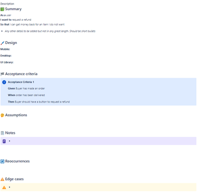

I've created a very useful Story description field layout for our Project that I'd like to use as a template across every new Story that is created. The plan was to create an automation that edited the Description field of a Story when it was created.

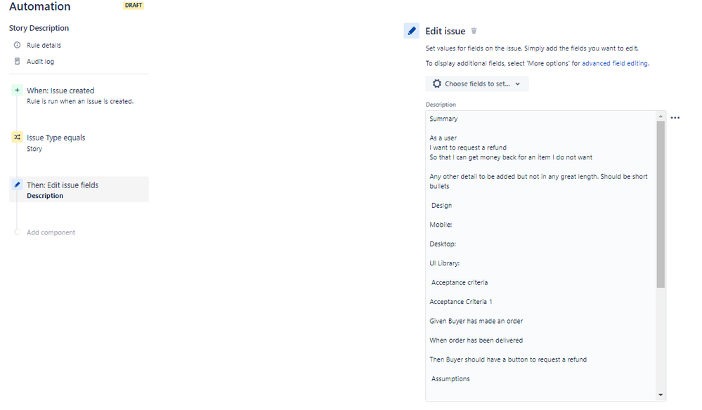

The problem is that when I try to paste the Story description field template into the automation process it only copies the text and none of the emoji's or info panels.

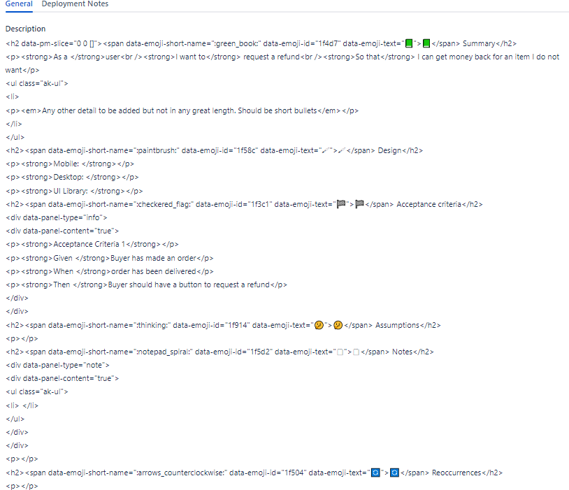

I've tried pasting the Story into an external site justpaste.it to grab the HTML and then paste this into the automation process but this just displays HTML in the description when the Story is created.

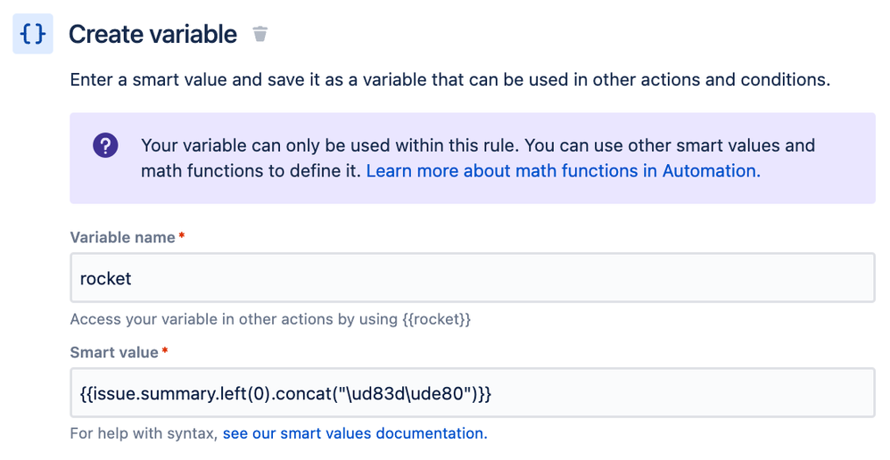

Hey Alistair, I figured out how to add emojis after some painful testing.
Recipe:
  1. Firstly you need to find out the low level character codes (surrogates), luckily some sites list them.
  2. So once we have the emoji code in Java e.g. "\uD83D\uDE80" for the rocket emoji we can simply insert it in the.. no wait, not so fast.
  3. We need to create a string and Jira doesn't let us do that in the templates directly. The easiest way is to use the Create Variable step with the name "rocket" and get an empty slice of an existing string, that way it can be reused:
    {{issue.summary.left(0).concat("\ud83d\ude80")}}
  4. Finally in the template we can insert our emoji:
    {{rocket}}
Result:
P.S. If someone can find a less painful way to do this, I'm all ears.
