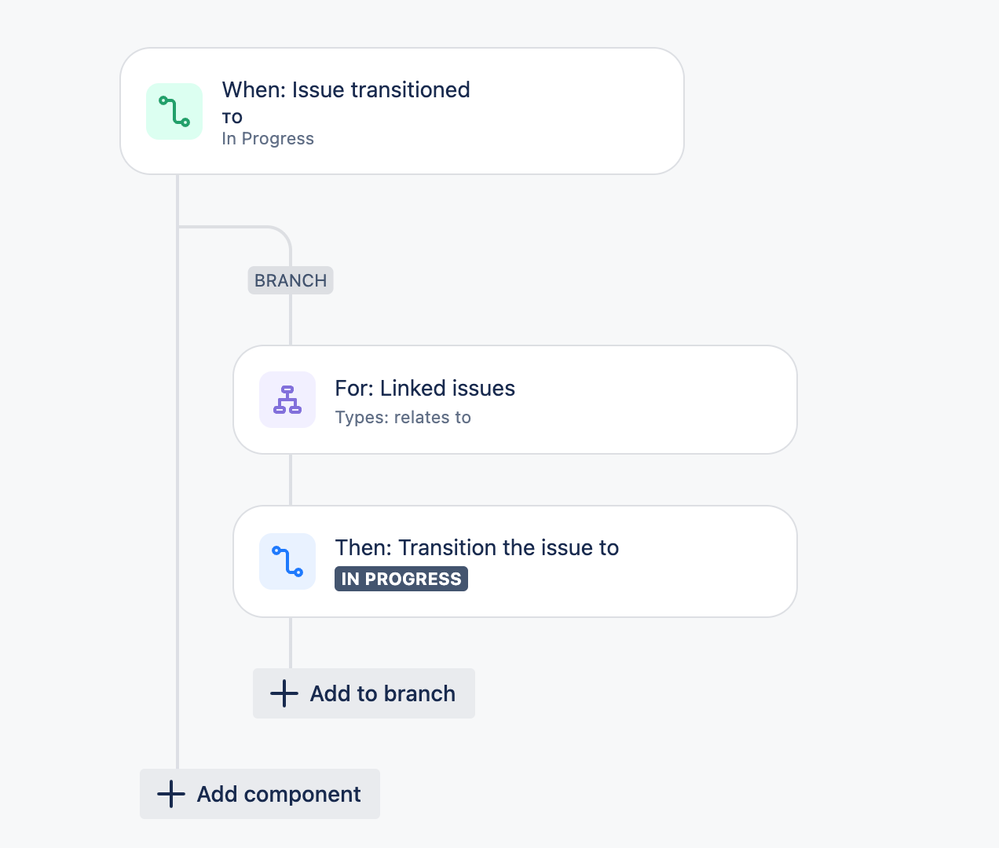

Hi @Shayden Frankhouser and welcome to the Community!
At the core, you basically need an automation rule that looks like this:
Because you are working across 2 different projects, you may need to make sure to include both projects in the scope of your automation rule (you can do so on the Rule details page). And also pay attention to the direction of the link between your issues (relates to may have an is related to counterpart representing the opposite end of the link.
If your issues are indeed sharing the same workflow, you could also choose to copy the transition from the trigger issue. That would make your automation rule more dynamic then when you explicitly select status names. You can add additional conditions to validate if your linked issues are in a certain status, etc. But from the above starting point, you should have all you need to get going.

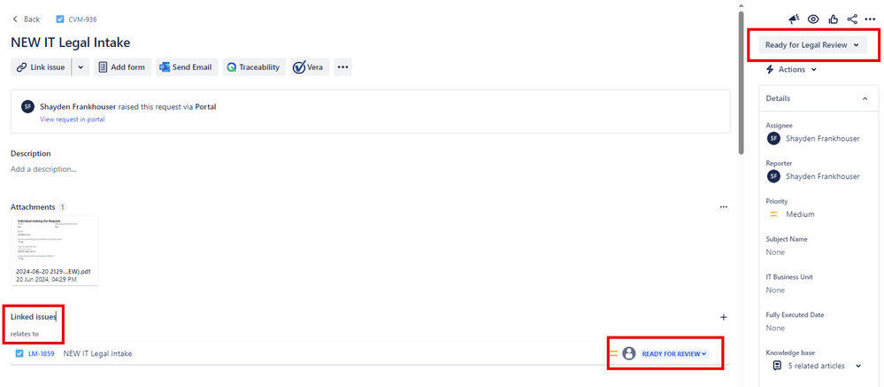

Hi Walter, thank you for the fast response!

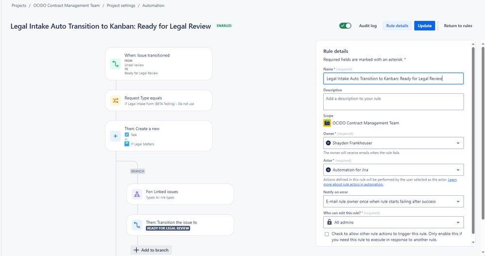

This is how I have it set up:
When I triage the request, I want to change the status to "Ready for Legal Review" - this creates a linked issue with the linked issue type "relates to" and a "task" in the JP kanban in the column "ready for legal review".

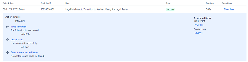

Problem: When this automation kicks in, it creates the task, and creates the linked issue type, but pushes it back to the first status in the workflow "Ready for review"
Here are my automations:
I'm also unable to add additional projects to my "scope".
