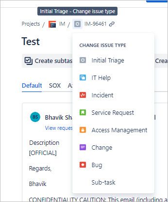

In our Org analyst have been leaving the default issue type "IT Help" when resolving cases. We have hence introduced a new Issue Type called Initial Triage which will be default set on any new case being created, and at the time of resolving a case a rule will check that the Issue type is not left as "Initial Triage".
For this I have introduced a custom field called var_IssueType. This custom filed is of the type Select List (single choice) and is configured to be set with values such as "IT Help", Change, Bug. Service request etc. I have further put a rule that will check Issue Type and set the value of var_IssueType. The value of var_IssueType if left as Inital Triage will not allow users to resolve a case and present an error message to change the issue type from Initail Triage to something more appropriate.

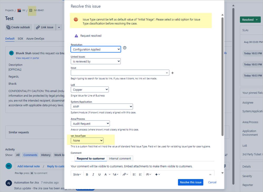

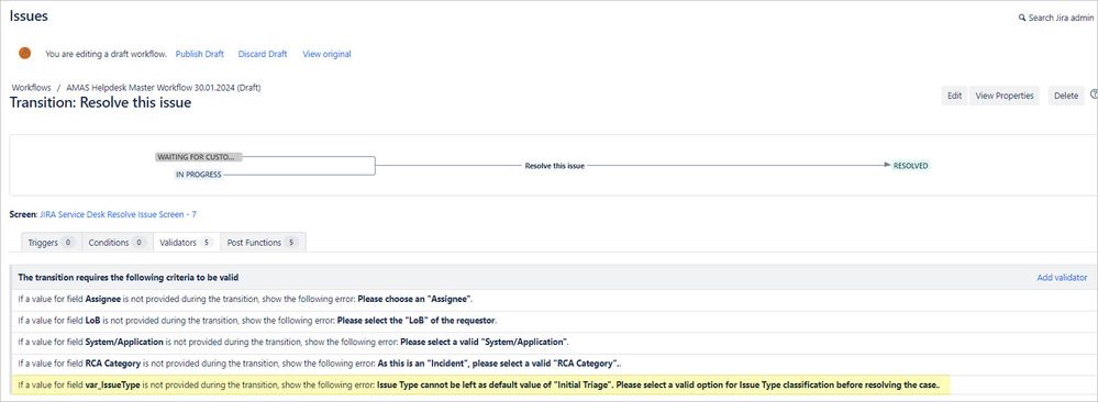

Bhavik.Shah
August 5, 2024
Hi Dick,
Thanks for the feedback.
I did want to try a simpler automation, but I could not get the standard Issue type field on the Resolution screen, nor at the resolution workflow step where we intend to put a validator; I could not find the Issue Type field to run a validation against. Hence, I had create a custom field that will hold the value of Issue Type which was being used into validation at time of resolution. Set up is something like below:
Regards,
Bhavik
