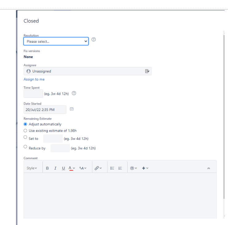

Hey,
I have two projects, A and B, and for some reason one of them shows a different behaviour than the other:
When I transition an issue to "Closed", project A opens up a screen titled "Closed" (see below) offering me a range of reasons why the issue was closed ("won´t do", "Duplicate", "hardware failure"etc.).
Project B simply transitions the issue to closed WITHOUT opening up this screen.
For us, it is important to know why an issue was closed for later follow up, and therefore we want the screen "Closed" with the options to select from displayed every time we transition an issue to closed.
I have tried to solve it so far and
- compared the workflows of project A and B for differences in the validators or Post Functions, as recommended in an earlier post  -  no difference
- copied the screem scheme from project A to B --> no difference
What can I do now?
Obviously the correct screen already exists in our Jira (and I don´t have to create a new one, as recommended earlier). How do I activate it?
Thanks so much - I spent days in trying to find the solution, and I am desperate for helpful advice.

Joe Pitt
July 21, 2022
The workflows are different. The one not opening the transition window has a post function setting the resolution field. You need delete the post function and use a transition window showing the resolution field
Girish_Shenoy
July 21, 2022
Please check the transition screen leading you to the closed status. make sure you have selected the correct transition screen that has Resolution field on it.
Andrea Nelson
August 15, 2022
Dear @Joe Pitt and @Girish_Shenoy ,
Thank you for your hints!
I was able to solve my problem now based on your recommendations!
... Very releaved and happy! :-)
