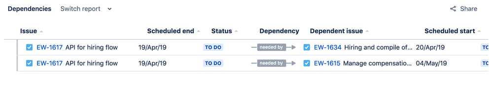

Screenshot 2019-03-16 at 9.01.00 AM.pngAnd I also tried JIRA portfolio, Dependency Report. It shows the the scheduled start and end date of depending case as below. But I am not sure how does the date set. I didnt set it specifically for each case. I just assign them to sprint. Then just want to see which sprint they are in and warn me if there's a case being depended are assigned to sprint later.
