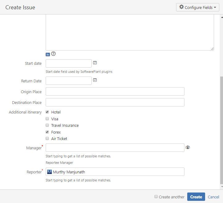

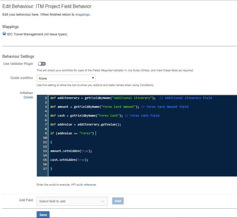

I tried your suggestion, but the fields are not hidden. Please see the screenshot below if i am doing it correct ?
"Additional Itinerary" is the field which has value called "Forex". If this value is selected only then the fields named "Forex Card Amount" and "Forex Cash" should be displayed, else these fields should not be displayed.
Fields in create screen Screenshot:

Hi @murthy manjunath , put the code on the server side , not on the initialiser. select your custom field on Add Field , put Additional Itenerary then place the code
Hope that helps

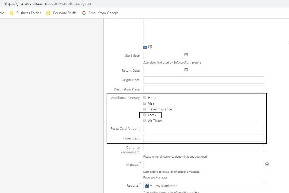

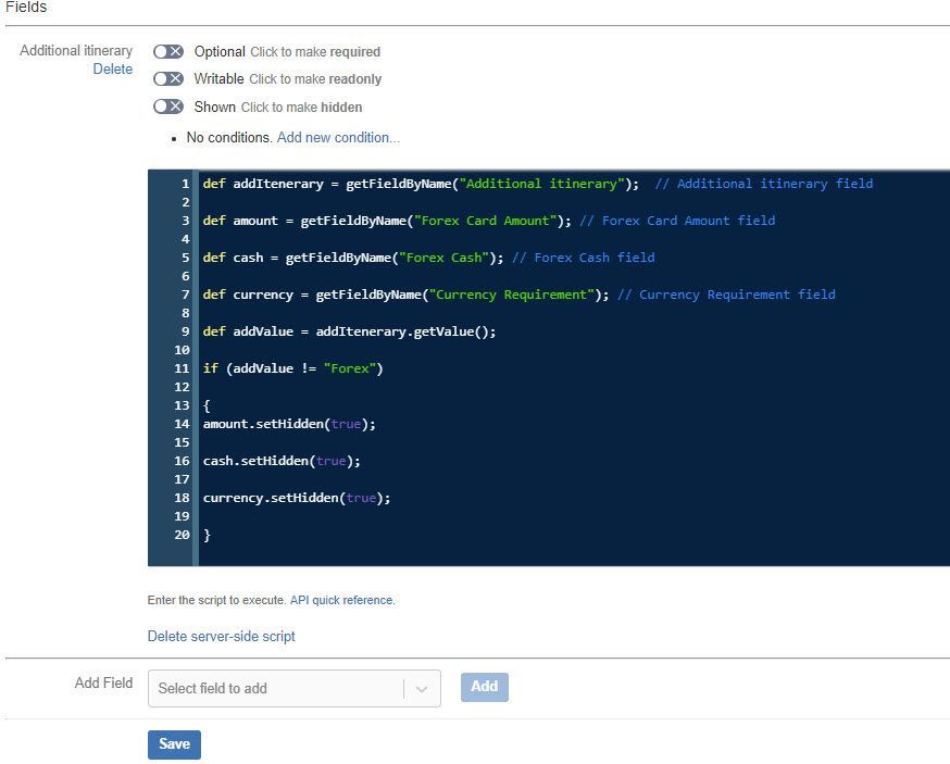

Thank you, I put the script in server side script by choosing field Additional Itinerary. However, here is the problem i am noticing.
Moment I select the checkbox value as anything other than "Forex", the fields are hidden. Later if I check the checkbox "Forex" fields are still hidden and does not display.
Here is the condition I am looking for;
If checkbox value of "Additional Itinerary" field contains value "Forex", then the custom fields "Forex Card Amount", "Forex Cash", "Currency Requirement" should be displayed.
If "Forex" checkbox is not selected then it should stay hidden.

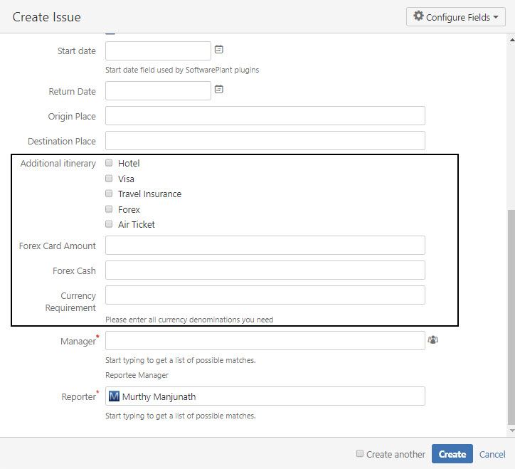

Screenshots of code an screens attached for reference.

Hi @murthy manjunath , do the else statement for the following scenarios. just follow the format, I didn't test it but it should work

Hi @murthy manjunath , what I mean is  you do the else statement based on your scenario
else {
 anyfield.setHidden(true)
anyfield1.setHidden(true)
like this
