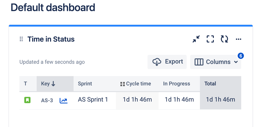

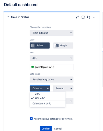

You can achieve it with Time in Status. To get dashboard that tracks how long the issues under a specific Epic have been in progress just simply
  • Install add-on
  • Create dashboard by Time in Status
  • Filter issues by JQL
    parentEpic in (x)
    replace X with your epic name
    and you will get summed time for all issues under the Epic. If you need to create dashboard for each issue under the epic, you can create dashboard for each issue using JQL as well.
For precise calculations, you can select your preferred work calendar and format.
Here we are!

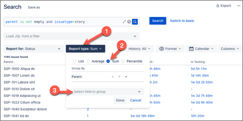

Jira doesn't have a built-in solution for the report you mentioned. If you prefer using a marketplace app, you can try Status Time Reports app developed by our team. It mainly provides reports and gadgets based on how much time passed in each status. You can group issues by Parent(aka Epic) and have a report similar to the below.
For further details, you can have a look at Status Time Reports How to Videos.
