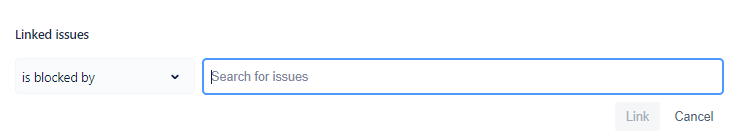

Creating a Linked Issue is not available. See screen below - the only option is to search for existing. And I don't see in the documentation for cloud that Create Linked Issue actually works yet.
I do see in the Permissions that it is supposed to enable this though....
