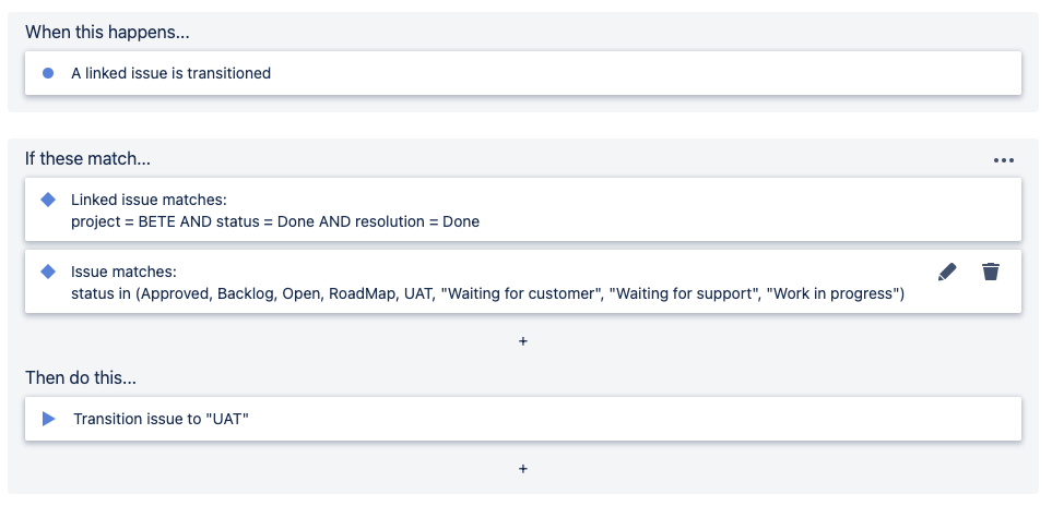

How can i change the status of a service desk issue only when all of its linked issues got resolved ? I'm able to do that once any linked issue gets resolved but id like to trigger it once they all are resolved instead

I'm using the rules on the legacy automation page. You can see it in the picture. Here, when a linked issue is closed, I transition the service desk issue to UAT status, but if there are other continuing issues that are linked to my service desk issue, I do not want it to transition to this.
There are issues from different projects linked to the service desk issue.
I couldn't find a way to do this by automation or by adding a validator / condition to the workflow.servicedesk.pngThanks for your help

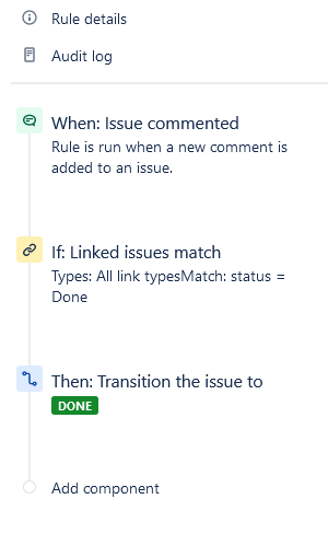

Using Automation I built you a rule the following - it is tested and works fine.
But this would need to switch to Automation.
The rule triggers on commenting your "main" issue and checks if ALL linked issues are in status "Done". If so, the "main" issue (the one which links all other issues) is transitioned to done, too.

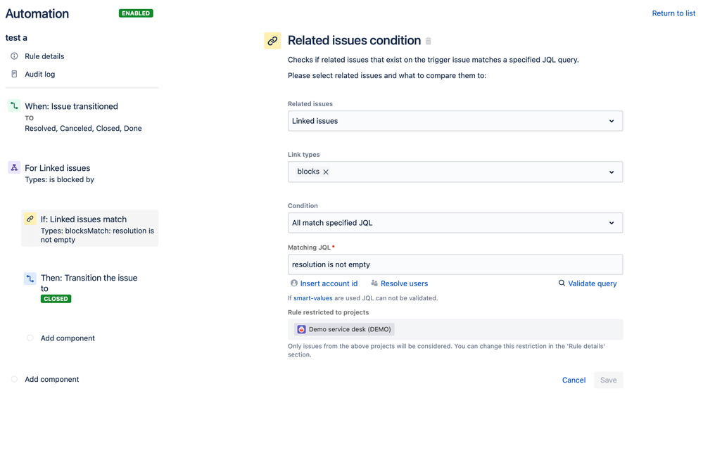

Alexis Robert
January 14, 2021
Hi @Berna Yavuz ,
this is possible with the Automation engine in Jira. You can create a rule that will trigger on a transition, check for the linked issue if all its other linked issues are also resolved, and then change its status. It might sound a bit complicated but you can see on the attached screeshot that it's quite simple :
Let me know if this helps,
