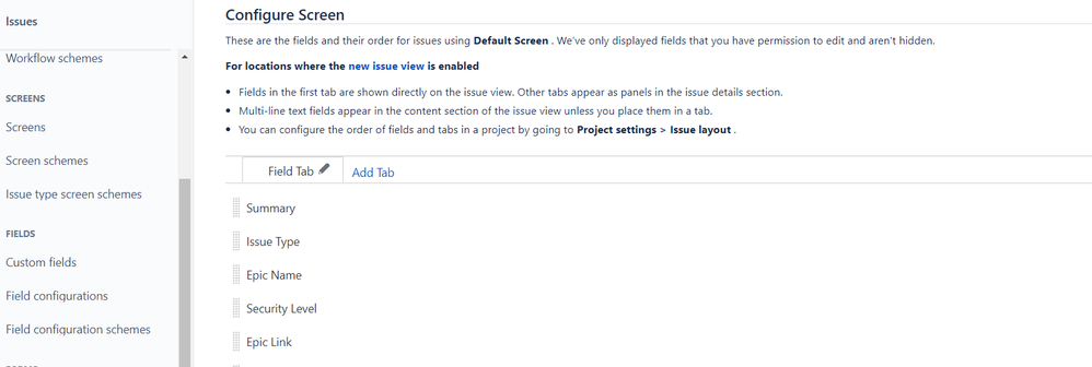

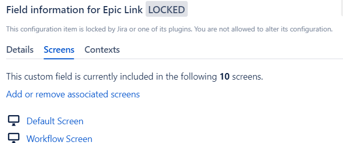

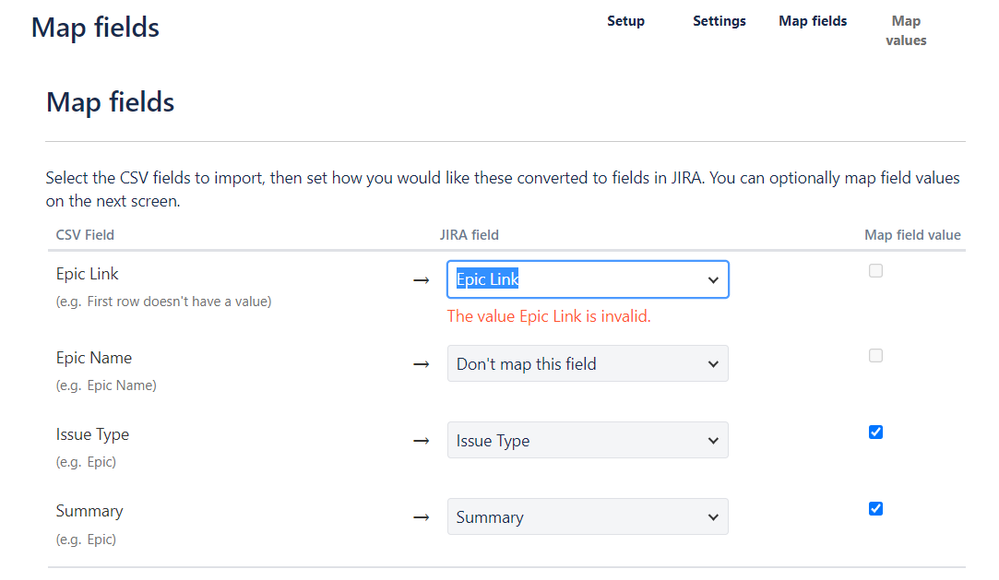

I'm trying to import Epics and their stories from CSV, to link Epic's to respective stories I'm not finding Custom fields Epic Link and Epic Name to map(my first screen shot). Below, I'm sharing my configuration details of my custom fields, requesting you please look into it and guide me.

Siva K.xyz.PNGabc.PNGScreenshot 2022-02-01 120437.pngScreenshot 2022-02-01 120535.png

I'm not getting epic link option, that's the problem. Please refer to my first screenshot, I edited my content. I want to know how to get epic link and epic name.

Here is my problem, I am not getting Epic Name and Epic Link fields to map while mapping before validation and import. Please refer my screenshots w.r.t custom field configuration, hope I'm clear. Please let me know if I need to provide more details.

Now, when you try to import this with the project import, you should find Epic link works fine. --> This is the problem I'm trying to ask from the beginning. I'm not finding Epic Link and Epic Name fields in the drop-down Jira Fields(custom fields) list during import procedure. What configurations I need to enable them.

The only other thing I can think of is that the epic link field is not even valid for the issues you are trying to import.
This will only happen if you've removed the field from the project somehow (as a locked field, you should not be able to do this on Cloud, although you could hide it or remove it from screens, which should not actually affect the import)
Simple test - click "create" and try to create a new issue in the project you are trying to import the issues into.  Are you offered the "epic link" field?  (remember to check "where's my field" to find out where it's gone if it is not given to you)
