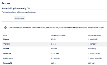

Most issue links create a relationship that indicates the issues are not interchangeable in the relationship, such as "parent" and "child", or "clones" and "is cloned by", or "blocks" and "is blocked by". These labels are used in the Inward Description and Outward Description of the link types:

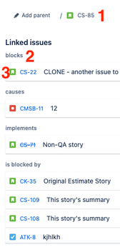

When you look at issues you see those labels in the Linked Issues section
When you "read" the information you order it as "1 2 3"; i.e.
CS-85 "blocks" CS-22
CS-85 "is blocked by" CK-35
For the Automation Rule Issue Linked trigger, the issue (CS-85) that shows the Outward Description ("blocks") in the Linked Issues section is considered the "source" issue, regardless of the issue from which the link is being created.
Let us say that I was viewing issue CS-85 and I created the link to CS-22 with the relationship as shown: CS-85 blocks CS-22. Then the rule would be triggered by CS-85.
Now let us say that I was viewing issue CS-85 and I created the link to CK-35 with the relationship as shown: CS-85 is blocked by CK-35. Even though I am creating the link while viewing CS-85, it is CK-35 that will cause the rule to be triggered because CK-35 is where we would see the Outward Description (blocks CS-85) displayed.

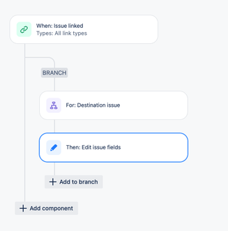

The problem with this is that the Edit action is being applied to the triggering issue - JS-66. Actions are applied to the triggering issue unless you change the rule's focus to a different issue.
You need to change the issue focus to the other issue in the issue link pair - the "destination" issue.
