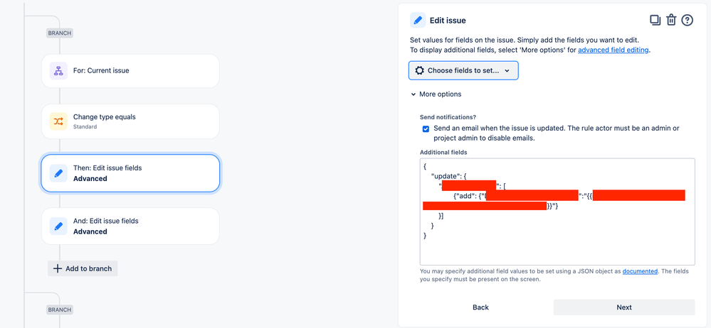

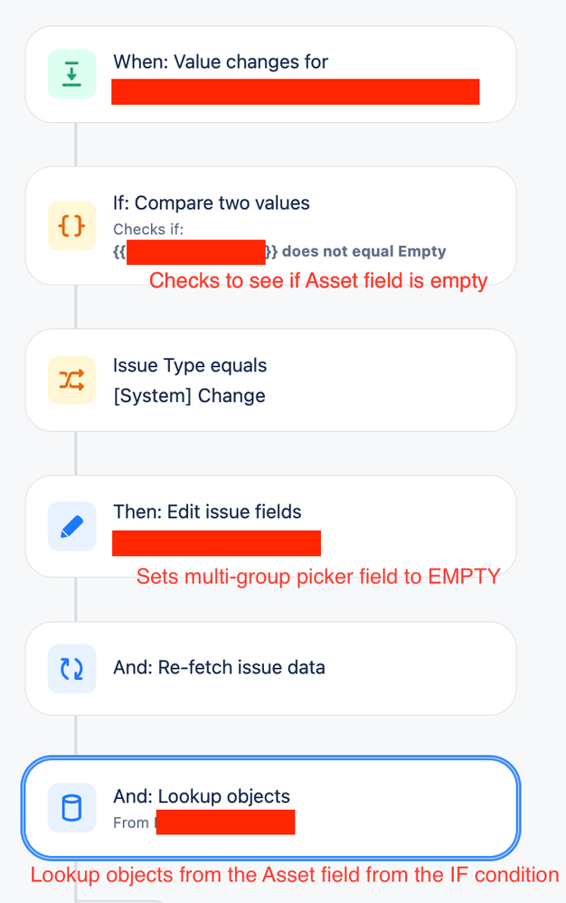

Scenario:
A team has requested that we append a group (defined in a Group attribute under an object schema they maintain as the CMDB) to a multi-group picker field within an issue using Jira automation.
Question:
Is it possible to do so? And, if so, how would that be setup?
Current attempt:
JSON:
"update": {
"MULTIPICKERGROUPfield": [
{"add":"objectAttribute":"lookupObjects.ASSETFIELD.objectAttribute}}"}
Screenshots of layout:
Resulting Error:
ISSUE (Operation value must be an array of group objects (customfield_10810))

I've added the steps to define the variables at the beginning of the automation, after the lookupObjects action, but still seem to be running into an issue with what I'm passing to be appended.
Using your suggestions, I modified the JSON to the following:
"update": {
"multiGroupPickerField": [
{"add": "{{varJson}}"
 I'm getting the following though:
ISSUE-1 (Operation value must be an array of group objects (customfield_10810))
I'm assuming that I'm getting the group as a string, rather than any type of ID. And maybe that's the cause of the issue?
