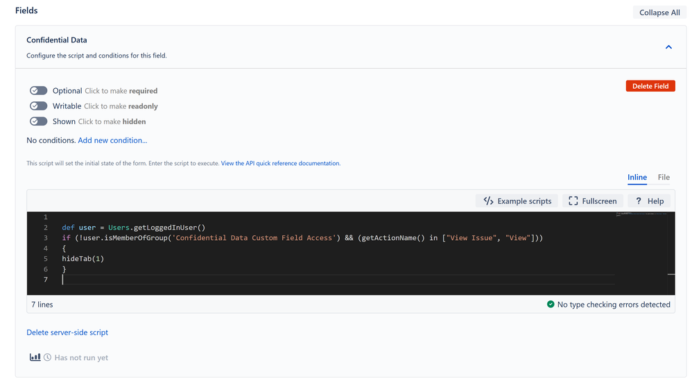

Hi Team,
I was trying to hide a field in the view because it contains confidential data. This information should only be visible to a select group of people. To manage this, I created a group and added the appropriate individuals. I then attempted to hide the field using a script runner behavior. However, even with this adjustment, the field still appears in the ticket view if it contains data.
As an alternative, I placed the field in a specific tab and tried to hide that tab. I successfully hid the tab with the field during the creation process, but it still shows up on the view screen.
I used this script. Is there a possibility to hide it from the view screen, but the specific user can also edit and update the field once the ticket is created?
def user = Users.getLoggedInUser()
if (!user.isMemberOfGroup('Confidential Data Custom Field Access') && (getActionName() in ["View Issue", "View"]))
hideTab(1)

Behaviour is not the correct approach if you intend to hide a field or tab on the view screen.
Behaviour only works on the Create, Edit, Transition and Assignment screens.
If you want to hide the field on the view screen, the best approach is to use ScriptRunner's fragments.
You can refer to this Community Discussion for more information.
