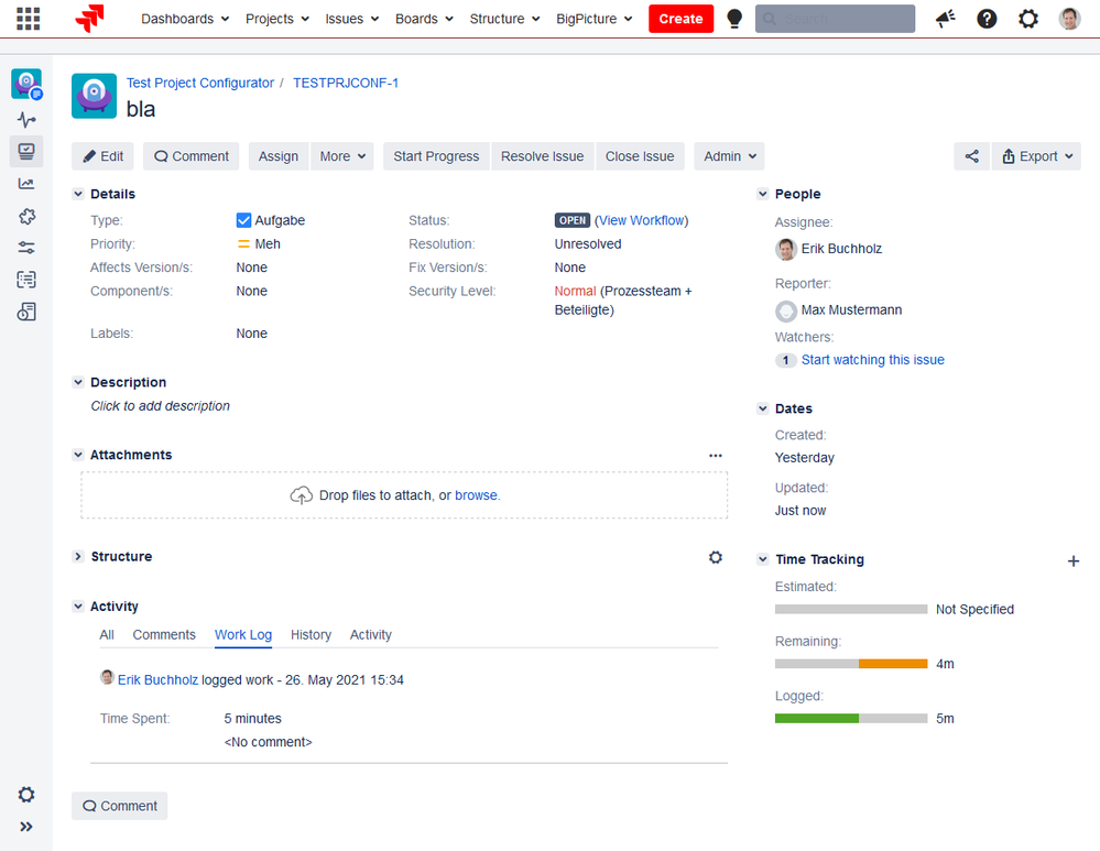

we want to hide the work log tab from activity panel (with all, comments, work log, history and activity) in the issue view.
I tried to use scriptrunner hide UI fragment but I can't find the right element.
I found the elements to hide the actions to create a new work log item but not the tab with the history.

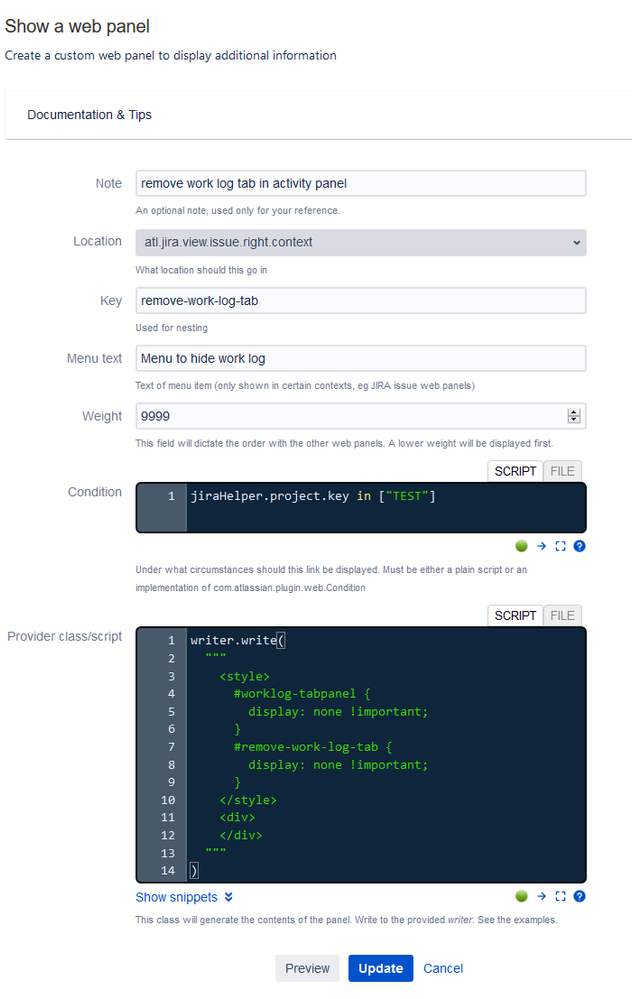

With your answer I found following solution:
With _show a web panel_ fragment I can use a condition with context of the project or issue and the current user. With the key I can hide the panel itself in the same way.
condition:
jiraHelper.project.key in ["TEST"]
script:
writer.write(
<style>
#worklog-tabpanel {
display: none !important;
#remove-work-log-tab {
</style>
<div>
</div>

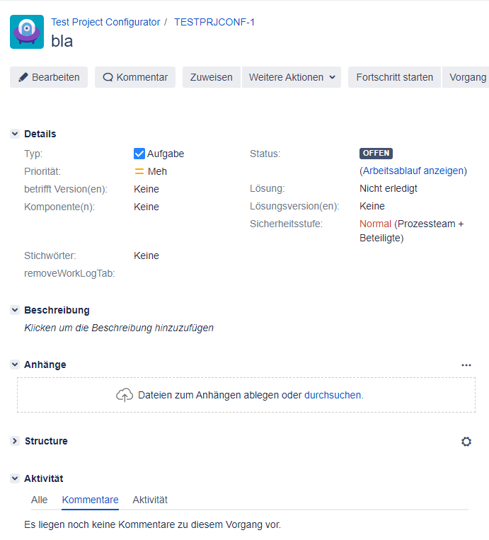

You could use a scripted field with the code below:
return """
<style>
#changehistory-tabpanel {
#worklog-tabpanel {
</style>
<div>
</div>"""
Ioana
May 27, 2021
@Erik Buchholz , I just saw your screenshot. The script I posted should help you hide it.
Erik Buchholz
May 27, 2021
Hi @Ioana ,
thanks for your answer.
Yes we want to hide it only in one project for certain users. So I modified your code a little and it works so far, if the field is in the right context and on the view issue screen.
Little disadvantage is that the field name is in the screen.

Erik Buchholz
May 26, 2021

Could you please share a print screen of which worklog tab you are trying to hide?
Thank you and Kind Regards,
Ram
Erik Buchholz
May 27, 2021
Hi @Ram Kumar Aravindakshan _Adaptavist_ ,
I added a screenshot to the question and tried to clarify that it's in activity panel.
