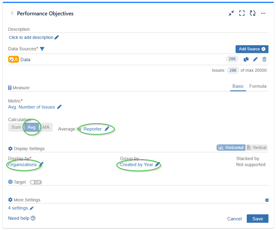

You can build this report with Performance Objectives: Charts for Jira app.
Here is how the settings screen would look like:

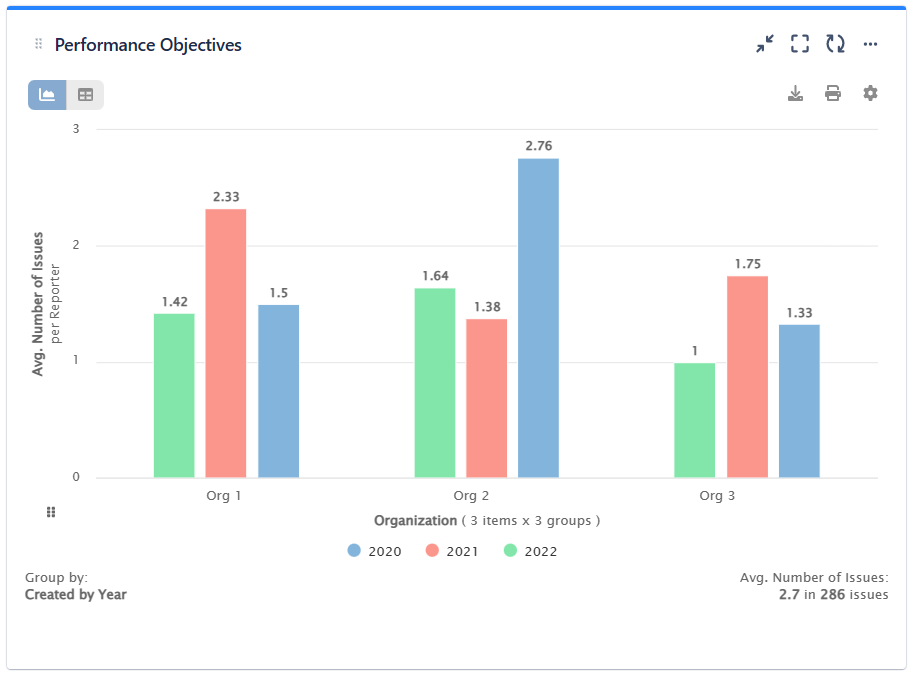

and here is a sample visualization of the report on a bar chart:

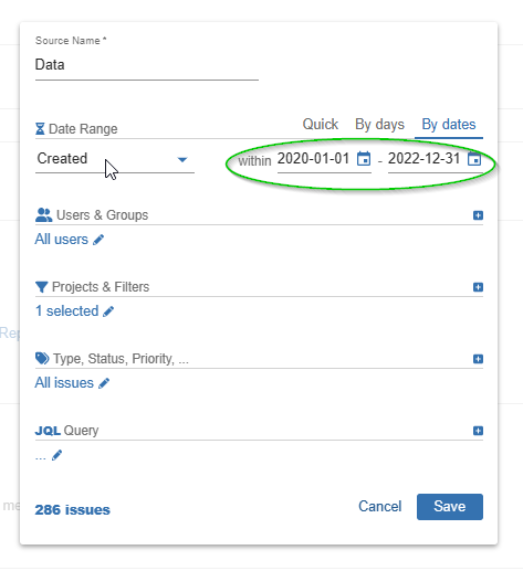

I've installed the application under the trial period and have a question.  In your example is the "Group By" filter grouping the tickets based on the create date of the ticket?
Thanks!
Tanya _DevAcrobats_
January 29, 2023
Hello, James,
Yes, the tickets are grouped by 'Created' field. The Data source for the example is also set with Date Range using 'Created' field:
