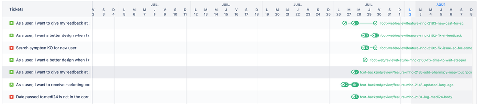

The integration seems to work well for deployments that occurs on my branches. I can see them in Jira:
My problem is that I do not see any deployment of those features when the branches are merged back in master for a deployment on our Development environment.
