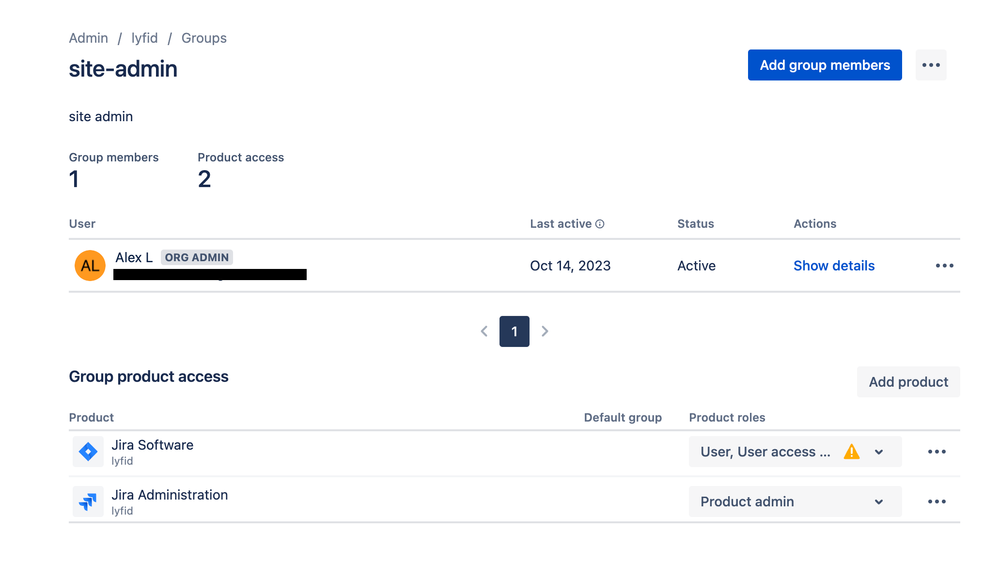

Thank you for your reply @Jehan Bhathena . I created this new group, added my account and all the administration rights for the Jira Administration and Jira Software products.
I then logged out and logged back in. I then added the Gitlab For Jira extension, but the outcome was the same. The same error occurred.

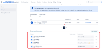

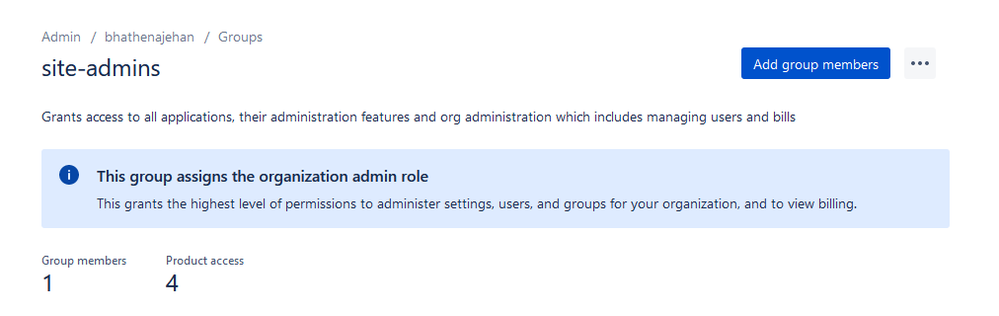

Hey @[deleted] ,
Attaching a screen shot of the configuration at my site
can you try to replicate this and let us know how it goes?

I just noticed that in the screenshot that you shared you've named your group "site-admin", can you try to rename the group to "site-admins" and try again?
