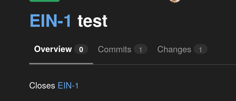

I've set up GitLab for Jira as the guide says (got the API token from Jira, added to Gitlab, got the App in Jira). Right now, I'm able to go from Gitlab to Jira via Merge Requests and commit messages (as you can see the issue ID is converted to a link):

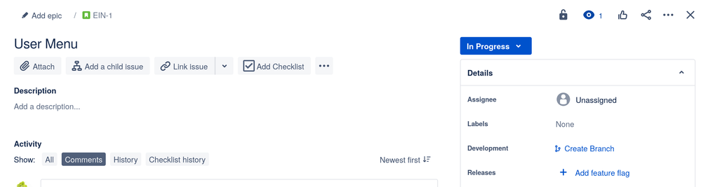

The inverse, however, does not occur. When I do all of this on Jira, no Web Link is displayed, nor my branch name:

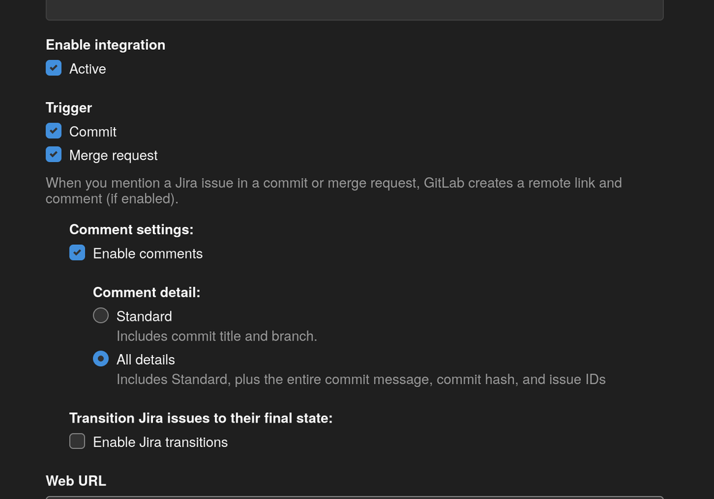

My GitLab Jira integration page (which displays Connection Successful):

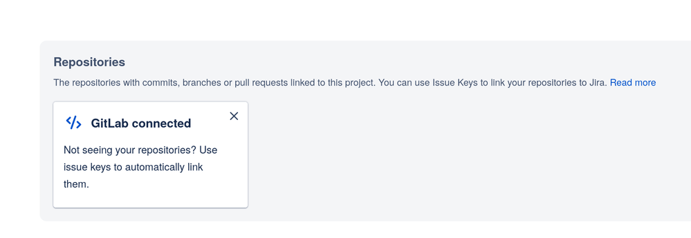

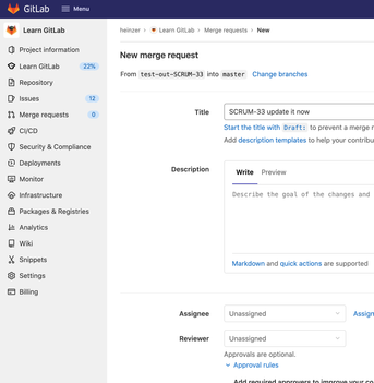

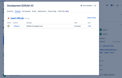

I tried to recreate this problem in my own cloud site, but so far I have not been able to.  When I tried to reference a Jira issuekey inside a commit and branch name, I am able to see those reference within Jira in a matter of a few seconds.
