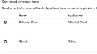

You can definitely have two repositories linked to one project as you can see I have Bitbucket and GitHub connected to one project:
