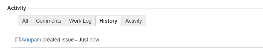

I need to fetch all histories for issue history migration through script. While I am able to get all the change history objects after the issue is created, I am not getting the flag (who created the issue with time stamp, probably because it is not change history, but only history).
This is needed as in case of excel migrations, if we want to update history/comments through script, we also need the first history about creation of issue.
I don't see any other API than Change History. Any help will be appreciated. Below line is missing, rest all change items are available through API
Singh Deo, Anupam created issue - 03/May/19

May 30, 2019
Hi Alexey,
I created an issue just now, you can see it comes (attached). I am not getting this event from change history. All changes after the issue is created are available from API.

AnupamS
May 30, 2019
Hi Alexey,

AnupamS
May 30, 2019
yes, but is there any way that I can get this event through an API? Ideally speaking in migration through some file, we won't have any comments or histories. While we can get all the change history, we are missing this first event. In order to maintain consistency, we also need this very important event details. One way to think is maybe append reporter and time of creation, and maybe add it as an item, but reporter can also be updated through API, and hence this becomes unreliable.
I am hunting for any way to get this information and set it in the history as it is in the image I sent, before publishing any change histories.
