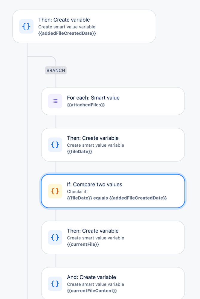

Hi @Pierre Ibrahim You had an accepted answer, but I did it by using the advanced branching:
So, I grabbed the created date of the file added by implementing {{attachment.created.max}}.
Then I made an advanced branch on the attached files of the issue.
I created a smart value out of the created date of the file iterated and compared that to the created date of the file that was in the variable of addedFileCreatedDate.
That condition should then fire only once (provided you did not add the same file twice, but I think the created date is when it was aded to the Issue).
Weirdly enough the created variable in the loop isn't accessible outside the loop. I'm still trying to find a way around that.

Hi @Milo van Loon -- Welcome to the Atlassian Community!
Branches which could be on more-than-one-thing are run in parallel and asynchronously, with each item in a separate processing space.  And so any variables created / changed in such branches are gone when that item finishes processing.
And...there is no guarantee of when such branches will finish processing, up until the last step of the rule.
Putting those things together, it is not possible to solve the scenario as you have shown.

Hi @Bill Sheboy,
You would be correct If I was comparing the looped data with a value that I retrieve after the loop. But I'm comparing it with a value that I captured before the loop. And then it will just compare it in an if block.
Adding the data in this if block will result in consistent data. Provided you keep within the loop and within the If block.
As I can see in the log of the rule, the loop is always ran after the fetch of the variable data.
I could do a re-fetch of the data in the beginning to be absolutely sure.  But as far as I can see the rules fires consistently.
