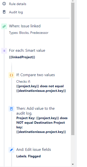

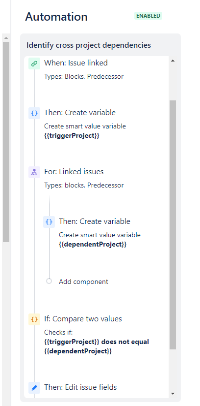

The first method I posted did not work when multiple blockers or issues were linked. This one covers all cases I think and is simler:
I was able to do this without an app buy using jira automation to label all cross project dependencies and then I created a filter off that label:
