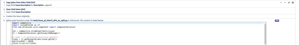

Could you please add a screenshot of your create issue post functions and describe your process - mainly how you create your linked issue and how it visually appears on the source issue.

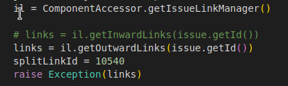

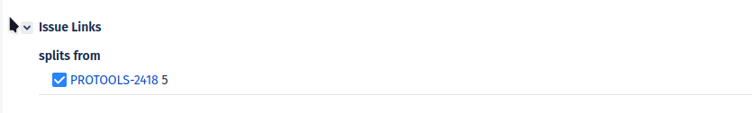

Im using "Split issue" functionality to split issue into two, this creates "splits from" and "splits to" links. I've linked the pf to issue Create step and it is called when split issue is created.
The relevant code is in the screenshot, I'm purposefully raising an exception there to see in logs if any links were captured(they are not)
