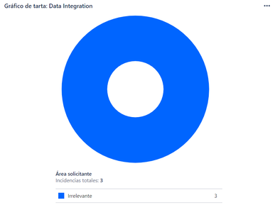

I have an error when I want to create a new gadget in Jira.
As you can see, the content appears as Irrelevant when that field has content:

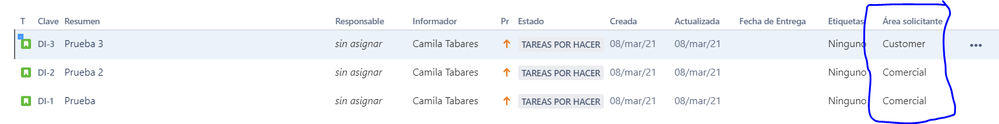

If I click to see the detail, the column "Area Solicitante" has content:

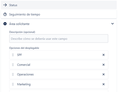

That field works for another project because was created as a list field but in a "last generation" project. So I thought that field was the same what I found in Personalized Fields, but is different, (single line) with the same name.
Here is in "last generation" project:
But here doesn't appears, there are two different fields:
So, I think I have to create a list field, in this classic project.
Do you have any comment?
Thanks!

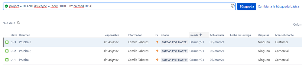

Would you please post images of the settings you used for the gadge and the JQL used to obtain the listed issues?  Perhaps there is a difference between them impacting the gadget.
Best regards,
Bill
Patricio Rodriguez
March 10, 2021
Hi @Bill Sheboy !!
Thanks for your answer. Below is the Gadget Configuration, and the JQL:
project = DI AND issuetype = Story ORDER BY created DESC
Let me know if you need anything else. Thanks!

March 10, 2021
Hi @Patricio Rodriguez
Thanks for that information.  Just to confirm, are you showing the pie chart for the entire project or for a specific filter?  In either case, "irrelevant" seems to appear in two cases:
  • When issue values are transitioning from one value to another.  If you are consistently seeing this value, that is unlikely.
  • When one or more of the issues returned (project or filter) do not have the custom field you are displaying.
Here's another post that seems to indicate those causes:
https://community.atlassian.com/t5/Jira-questions/What-does-quot-irrelevant-quot-mean-in-a-JIRA-pie-chart/qaq-p/351381
If it is neither of those causes I suggest asking your site admin to submit a ticket to Atlassian support here:
https://support.atlassian.com/contact/#/
And after you learn more from support, please post back here so others can learn the cause.  Thank you!
