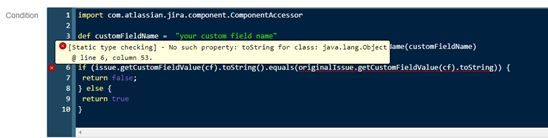

Hello Alexy, thanks for the help. Unfortunately I get an errormessage (see screenprint attached). Errormessage on Listener coding.JPG"tostring" seems to be the problem. How to correct?
Alexey Matveev
July 23, 2018

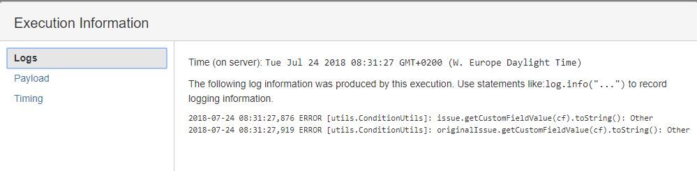

Hello Alexey, Thanks for thinking with me. I added the log coding and when I execute now I get following information: Errormessage with log.JPG
The 2 log lines tell me that new and original value of my custom field "employee type" are both value "other" and that's not true. I changed value "Internal" to value "Other". So my original value is not correct. What's of in my coding making Jira think that both new and original are the same as they are not? Thank you for your help again.

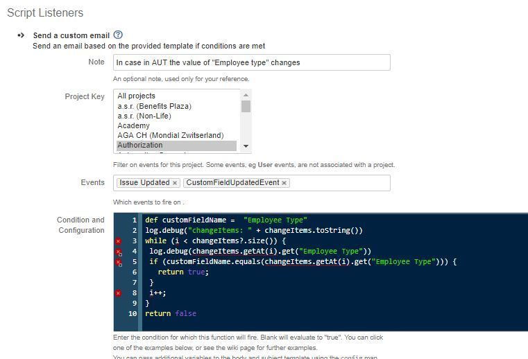

Hello Alexey, sorry for my late response, busy with a lot of other Jira stuff. I'm sorry, but I don't understand your peace of code. I get to this point:
but why the red "x"? What in the syntax is wrong? I'm sorry, I'm not trained in this coding, all learning by myself, thanks for your help
Alexey Matveev
August 9, 2018
It could be static errors. You can execute this script
