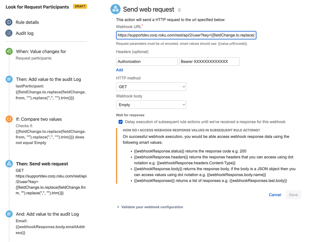

Ok, if you're somehow going to be able to train/limit your users to only add ONE Request Participant at a time, then you could do this with a Web Request to Jira's Rest API.
You can make a call to this endpoint to "lookup" the email address:
https://YOURSITE/rest/api/2/user?key={{fieldChange.to.replace(fieldChange.from, "").replace(",", "").trim()}}
This returns a response that includes email, which you can access as:
{{webhookResponse.body.emailAddress}}
So I'm roughly following these instructions:
With the difference being that Personal Access Tokens in on-prem Jira are used as Bearer tokens. So the Header is slightly different and requires no base64 encoding.

Aw man. We really need to be able to SORT both lists and then DIFF them. Hum.
