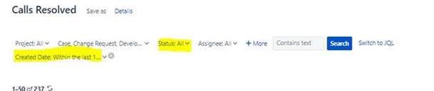

Can you please assist with some of the filters my colleague has created
he has created a filter and every morning it goes back to default and we don't know what is causing that, has anyone experienced something like this before?
this is the default filter: that he gets in the morning and its not what he has on his created filter

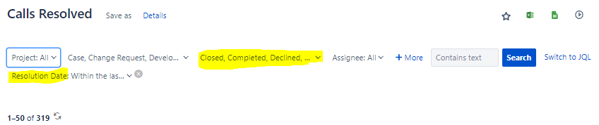

Filter.jpgthis is what he created and saved it

You know I’m not sure the filter is actually changing TBH. If you compare the results of the two are they the same? If you look at the JQL it may be they are functionally the same. For instance your first indicates “all” statuses and the second simply appears to list all statuses out. So it is likely the SW is simply translating the filter differently but is functionally the same. Maybe...

the results are not the same
Yes we want to see Issues that are resolved not all status
hence the one state status we only want to see "resolved, Done, Completed and Rejected"
the status all its the one the filter changes to and we dont want that results .
The out come of this filter its must show calls resolved within the given date
