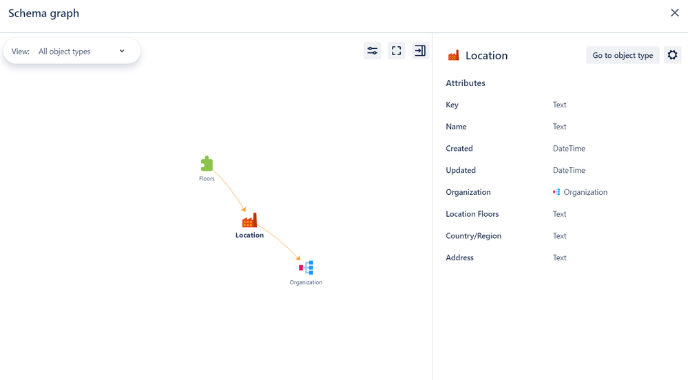

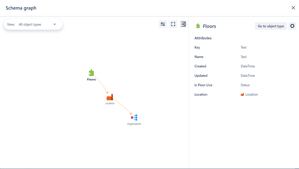

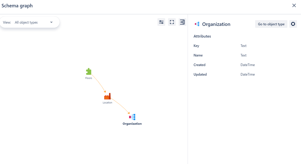

The schema has 3 different objectTypes: Organization, Location & Floor
Each floor has an attribute that links it to the relevant location and each location has an attribute that links it to the organization that works out of the location.
