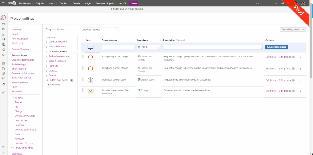

I'm trying to edit the fields of a custom Request Type, I'm getting an error saying: "Field does not belong to the Request Type."
Does anyone know how to solve this?

The error occurs whenever we try to edit a newly created Request Type with a specific Issue Type - "Access". Access fresh screen scheme with new custom fields and system fields.
We have tried removing all custom fields in the screen as well as adding all system fields, we're still getting the same error message whenever we associate "access" to a Request Type.

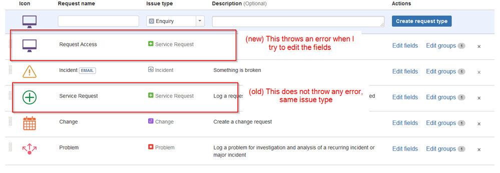

Hi, Andrew.
When I create a new Request Type with existing Issue type (not custom), I'm getting the same error whenever I try to edit the fields.
