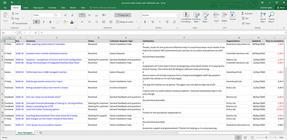

You can export the customer satisfaction rating and also the customer satisfaction comment with Better Excel Exporter (see column "F"):

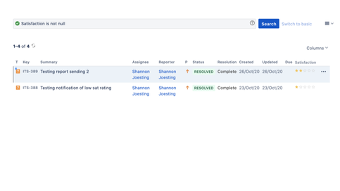

I don't know about server, but in cloud JSD you can do the following.
Use the JQL: Satisfaction is not null
And then pull the field "Satisfaction" into your results. It'll show up as stars in the Jira view, but when you export to CSV it is a number value.

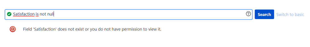

Thanks Shannon! Could you please be so kind to provide some screenshots? I am using JSD cloud and cannot choose/pull the field "satisfaction" nor my admin does.
That is the correct JQL, so it must be a configuration situation. Maybe reach out to your admin or submit an issue with Atlassian. They'll ask for access to login to your environment and be able to tell you what about the configuration is causing the problem.
