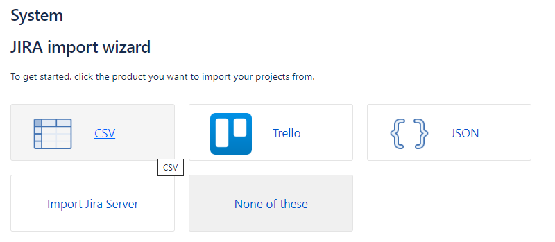

From where did you access the import functionality? It could be accessed from the Create Issue dialog, from the "View all issues" page, or from Administration > System > External System Import. I'm not positive, but you may be able to update existing issue only when you use the External System Import. And you definitely have to provide the issue key as part of the CSV file, so that Jira knows which issues you're trying to update.

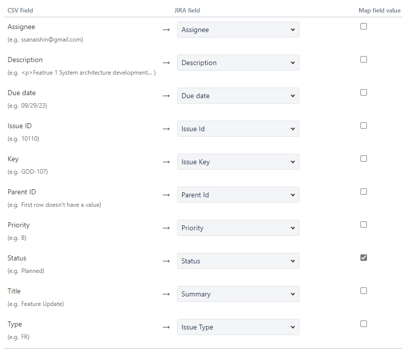

1. Did you provide the issue keys for the existing issues in your CSV file, and did you map that field during the import process?
--> yes my csv file hase issue key
--> I also map that
2. From where did you access the import functionality? Administration > System > External System Import.
--> System > External System Import.

Don't include the Issue ID field. You need only the Issue Key field.
You must include the Summary field.
Otherwise include columns for only the fields you want to change in 1 or more issues. If you don't want to change the value in a particular issue, include the original value for that issue for that field.

@Trudy P Claspill I'm having the same problem and tried to not include the Issue ID field. However, I'm updating the Parent field so it requires the Issue ID field to do a lookup while importing.
It doesn't allow me to proceed if I map the Parent and don't include the Issue ID.

I couldn't find the access you mentioned above "Administration > System > External System Import".
Thank you so much in advance!
To get the widest visibility on your request for help, start a new Question by clicking the Ask a question option at the top of the community pages. Provide the details of your scenario including a sample of your CSV, and screen images of what you see when you try to navigate to the import function. If you think this post is relevant, include a link to it and explain the relevance.
