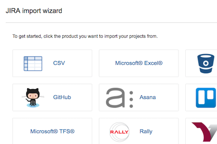

I created a CSV of blank issues and imported it using External System Import.
  1. Go to Jira Administration > System
    Under Import and Export is External System Import
  2. Select CSV
You can map the columns as needed. I was actually able to get a scan of devices on the network and then import that data using the same method.

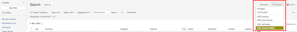

I also found it helpful to fill out the asset/issue info for one device then export that to a CSV and modify the CSV as required.
Then you can see exactly how each detail is mapped easily.
Go to the Asset Project and search.
Set your search criteria, select the columns you want and export to CSV.
