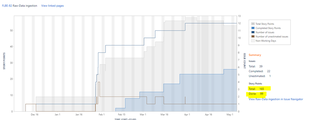

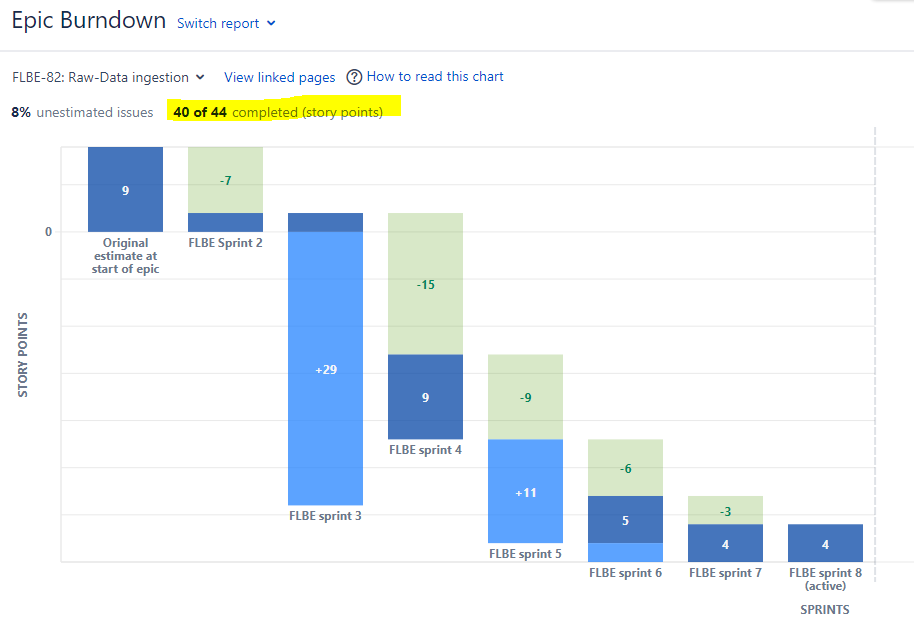

The "epic burndown" report shows only 44 story points for an epic that has 165 story points, many of the issues that were finished on previous sprints are not shown on the report while the "epic report" shows the info correctly.
Did it happened to anyone?

It is pretty common that the Epic Burndown Report and the Epic Report consider a different number of Story points since they work in completely different ways. Please, allow me to provide you with more details:
Burndown reports are calculated as "point in time" instead of the actual sprints or issues. These reports take into account when issues change and get updated retrospectively.
So, if an issue is closed at a point in time, it is counted against the sprint that was active at that time in the Burndown report. This issue does not have to be associated with that sprint in any way.
Now, Epic reports are much more straightforward as it looks to the issues that have been part of the sprint at any given point in time.

I understand that the amount of story point per sprint can be changed if an issues is closed after the sprint ended so it will be included in the next sprint.
I also checked a few stories that didn't appear in the sprint of the Epic Burndown report and found that their resolution date\time is before the sprint close date\time so I don't understand why they are not shown.
But more importantly, I do not understand why the total number of story points of the epic is different than the real amount of story points (this is 1 team, working on a single scrum board on their own project).
