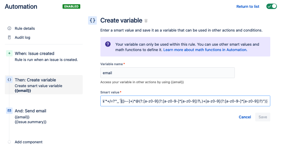

Testing on my local site and with the great help of my colleague, we were able to create an automation rule that will get the email address from the summary ![]()
In this case, it’s necessary to use Regex and create a variable that will store the email address added to the summary so then, it can be added as the “To” on the Send email action.
Go to the automation page and create a rule as it follows:
When: Issue created
Then: Create variable
Add a name for the variable, here we are using “email” and the smart value will be:
{{issue.summary.match("([a-z0-9!#$%&'*+/=?^_`{|}~-]+(?:\.[a-z0-9!#$%&'*+/=?^_`{|}~-]+)*@(?:[a-z0-9](?:[a-z0-9-]*[a-z0-9])?\.)+[a-z0-9](?:[a-z0-9-]*[a-z0-9])?)")}}

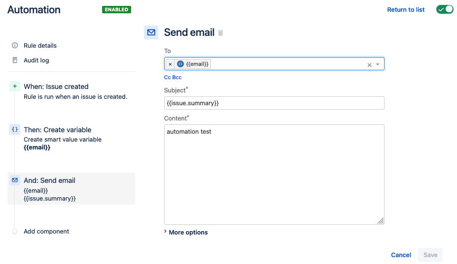

Then, add another action that will be “Send email” and on “To” add the variable that you previously created.

Hi Angélica,
I just created an automation rule using your email smart value regex and wow! That seems to do the trick! Thank you and your colleague very much!
