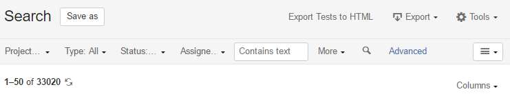

I beleive you can do this by switching to the "System" columns configuration seen in the "Columns" dropdown:
Only admins should have this "System" option - if you make changes here, changes should be reflected for all users.

Thanks. I found the Columns option and removed Status from the drop down menu but it doesn't remove the filter from the Issue Navigator for all users.
Alex Christensen
April 27, 2017
When in the Issue Navigator in List mode, you should see the dropdown on the right-hand side just before the list of issues begins.

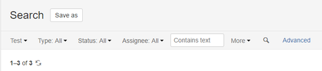

This is where I want to hide the Status filter:
Alex Christensen
April 27, 2017
Ah, sorry, I misunderstood - thought you wanted to hide the column only. As far as I know, this is not possible. There's an open Suggestion with Atlassian, as well.
