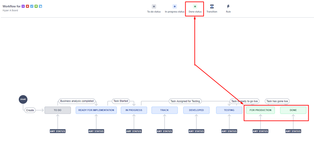

I am using JIRA next-gen to manage a scrum project.
I have configured my board as follows with two available "Done Status" columns.

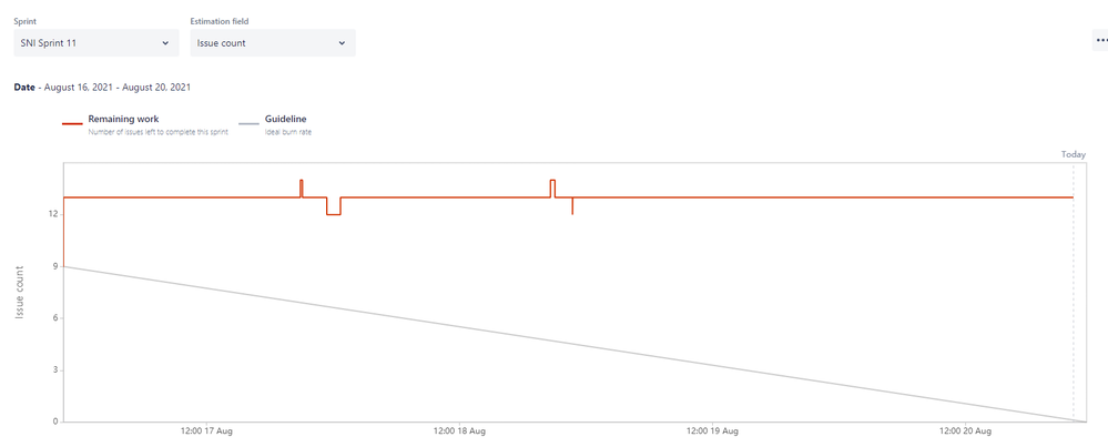

I expect when I move issues to any done status column - that action to be reflected in the Burndown or Burnup report. However, this is not the case. Only the issues which I move to the Done column are reflected in those reports. The result is a very sad Burndown chart at the end of a Sprint :( :D

Hi @Kiril Tsankov ,
this is because Jira considers an issue "Done" only when it's moved to the column that's further to the right of the board.
Since you column "For production" is not the furthest to the right, issues in it are not considered done. There is no workaround for this, so you'll need to keep this in mind.

In that case, what is the "Done Status" in the workflow configurator used for? Are you sure it has nothing to do with the burndown chart and we're not facing a bug?

The status in workflows is an indicator of where an issue is in your process.
The boards try to show you your process, based on those status, but you have to map the status into the columns (the default is a simple 1:1 mapping of column to status).
The status of an issue does not tell a board whether an issue is done or not, directly.  What matters to a board is the "done" column (rightmost one).  It's up to us humans to tell Jira which status belong in the "done" column.  That's the indirect link between status and burndown - you have to get your "done" status in the right place for Jira to match it to what it sees as "done".

Doesn't work for me.  My "Done" and "UAT" status (which are both of type "Done") are both in the right hand column on my Board, but the burn down chart on the board does not show "UAT" tickets as burned down - it waits for them to be in the "Done" status.  I am using Jira Server.

Can you show us
  • the board settings (just for the last column)
  • an issue that is not in the column while having the UAT status, including status, resolution, and the sub-task panel
  • your burn-down chart
  • the filter for your board (in boards that don't look to a filter, this will be "project = XYZ")  Plain text here, it's quicker than a screenshot.
On the issue view, we don't need most of it, so feel free to obscure most of it, we really do only need status, resolution, the estimation field (story points, time estimate or whatever else the board might be using), and to know the same for any sub-tasks the issue may have.
