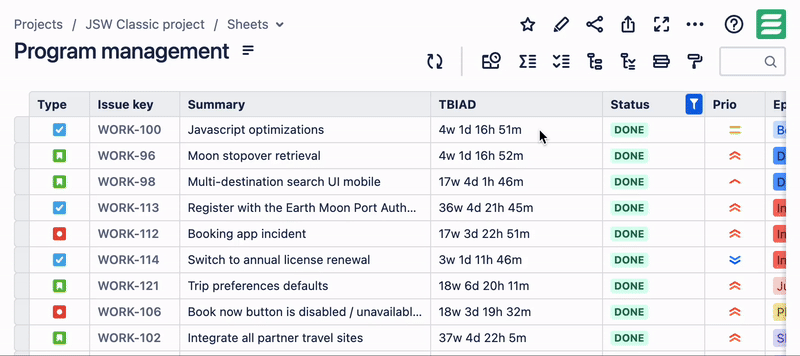

There's no built-in way to do so. I have seen people use Jira Automation to calculate these values (this article should be a good starting point), and of course you can always look at the issue history (either in the UI or via Jira's REST API) and do the math yourself.
Alternatively, if you're open to solutions from the Atlassian Marketplace, there are a number of apps available that operate in this space. E.g., my team and I work on an app in which your use case would be easy to solve, JXL for Jira.
JXL is a full-fledged spreadsheet/table view for your issues that allows viewing, inline-editing, sorting, and filtering by all your issue fields, much like you’d do in e.g. Excel or Google Sheets. It also comes with a number of so-called history columns that aren’t natively available, including time in [status], time between [status A] and [status B], and time between transition from [status A] to [status B] and transition from [status C] to [status D], along with many others.
This is how it looks in action:
As you can see above, you can easily sort and filter by your history columns, and also use them across JXL's advanced features, such as support for (configurable) issue hierarchies, issue grouping by any issue field(s), sum-ups, or conditional formatting.
Any questions just let me know,
Best,
Hannes

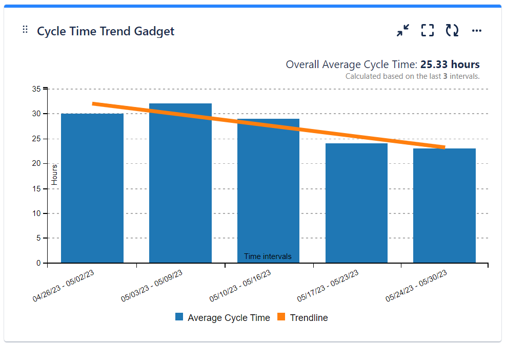

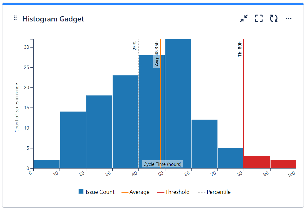

Hi @Pomme Duccini,
This can be easily achieved with the gadgets offered by our Great Gadgets app.
You can have these delta times between statuses calculated and displayed in various ways. And you have the option to configure what to measure.
These gadgets include a Data tab with detailed info about the issues, which can be easily exported in CSV.
See also this article: https://community.atlassian.com/t5/Jira-Software-articles/Building-a-powerful-Kanban-dashboard-in-Jira-with-Great-Gadgets/ba-p/1664331
Hope this helps. If you have any questions about our gadgets please contact support@stonikbyte.com.
