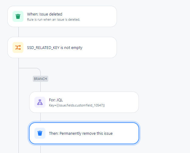

We have a custom field in Jira that contains the value of another Jira-key.
If an issue that has a value in this field is deleted, I want to delete the issue that is named here as well.

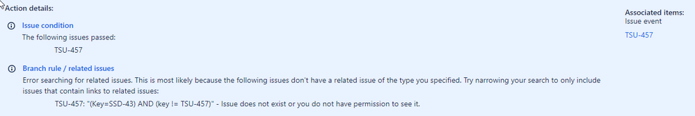

However, when I run the rule, it fails with the following error:
I’m a bit unsure why it has added "AND (key != TSU-457)" to the query.
Is there any way to solve this?

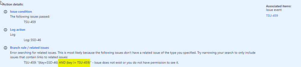

Some rule components such as Branch on JQL explicitly exclude the trigger issue.  This is to prevent errors, such as looping or walking over prior results.  That is why you see that expression added to the JQL: key != TSU-459
Next, the issues you show are in different projects.  What is the scope of your rule: single-project, multiple-project, or global?  A single-project scope rule cannot access issues in other projects.  To change the rule scope, your Jira Site Admin will need to help.

The rule is set up to run "Global." Since it adds "!= TSU-459" and this one has already been deleted, Jira Automate stops, so we can't proceed. Is there another way to perform an action on the related issue?

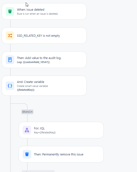

You can try with: Key = {{customfield_10547}}
Also if the issue/s are in different projects please ensure that the Rule is Global.

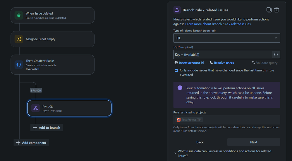

Create a variable
Hope this helps.

Thanks for the quick reply. Unfortunately, it didn’t help. We get the correct issue key from the custom field, but it still automatically adds the deleted IssueKey in the query. See the audit log below.
2024-10-03 15_42_17-Audit log - Automation - Jira og 5 sider til – Arbeid – Microsoft​ Edge.png
2024-10-03 15_39_18-Audit log - Automation - Jira og 5 sider til – Arbeid – Microsoft​ Edge.png
