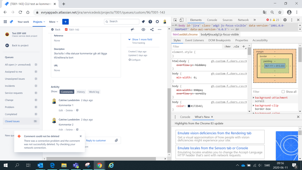

Hi,
Should it be possible to delete comment on closed issue?
I get the error message "Comment could not be deleted. There was a connection problem and the comment was not successfully deleted. Try checking your network connection".
Since I could delete a comment when the issue just was completed, I am not sure if there really is any connection problem, or if it is a strange error message that actually is due to status of issue.
BR
Catrine

Catrine Lundström
June 11, 2020
Hi Angélica,
No difference between browsers. Same result for colleagues and several classic projects .
error delete comment closed issue.pngBR

Thank you for the details, Catrine.
Since you are using a classic project, I believe that this issue is related to a bug:
If the workflow is shared between projects, that's probably why it's happening to several classic ones.
Please, check the description of the bug and remove the "jira.issue.editable" property from the status in the workflow.
Also, click on "This affects my team" and watch the bug to receive future updates.
