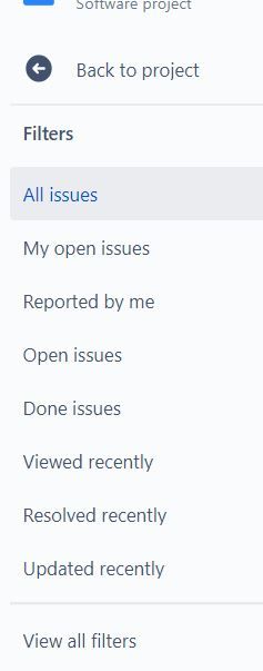

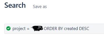

The permission scheme
1) in order to allow the users to view the project have the browse project permission,
2) all Boards, Dashboards are managed by filters that restrict displaying, only the correct group can view their issues,
3) there are default filters, supplied by Jira, when you create a new project these filters are not editable, nor can I hide them
4. the default filter displays all issues with no regard to the security level nor the permissions. it is attached herein.

eleanor kerman
June 29, 2021
These are the filters, that come out of the box from JIRA CLOUD, the filter is set by JIRA
I can not override it or save it as the same name Jiraa assigned.
The filter displays all issues belonging to the project.
I have a permission scheme by the filter ignores the scheme.

John Funk
June 29, 2021
Users should not see issues that they cannot see as a part of the security scheme - including the project level issues.
You can test by having the user run a filter for key = ABC-123
where ABC-123 is the key of an issue they should not see based on the security scheme. If they don't see it in the filter, they should not see it in the list of issues.
