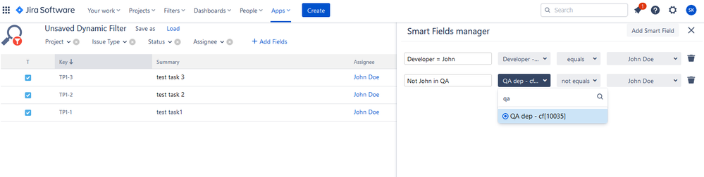

Hi @Arne Pulle
Also, you can look at the other solution Dynamic Filterimgpsh_fullsize_anim (1).png
