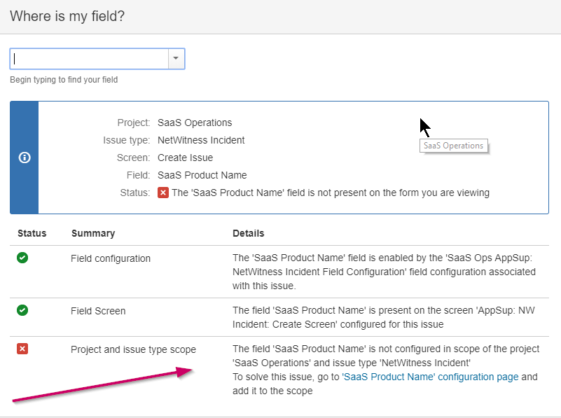

But when I try to create an issue of type B, I do not see the field. When I look for it, I get the error below. It seems that the project scope of context A won, as they say in the custom field config page:

Basically, the Custom Fields Contexts work based on Projects. Once you assign a Context to a Project you cannot add another one even when you use different Issue Types on the configuration of the Context.
