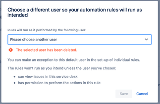

When I create a new JSD project using shared config from existing JSD project, I get the following error when trying to add or edit my automation rules:-
"Choose a different user so your automation rules will run as intended"
and
"The selected user has been deleted"

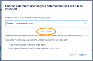

When I try to select a new users, I get the following error:-
"No options"

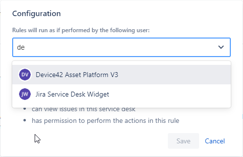

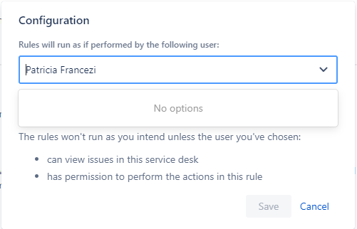

Patricia Francezi_iDev_
September 29, 2020
Per the snapshot you are using the legacy project automation for JSD.
Did you try typing the user name instead of waiting for option, as i mentioned earlier?
This is the problem, some bug, and I have the same problem here in my instance
No user showing when i click in the drop down menu
Started typing:
I know this is silly, but you should try.
