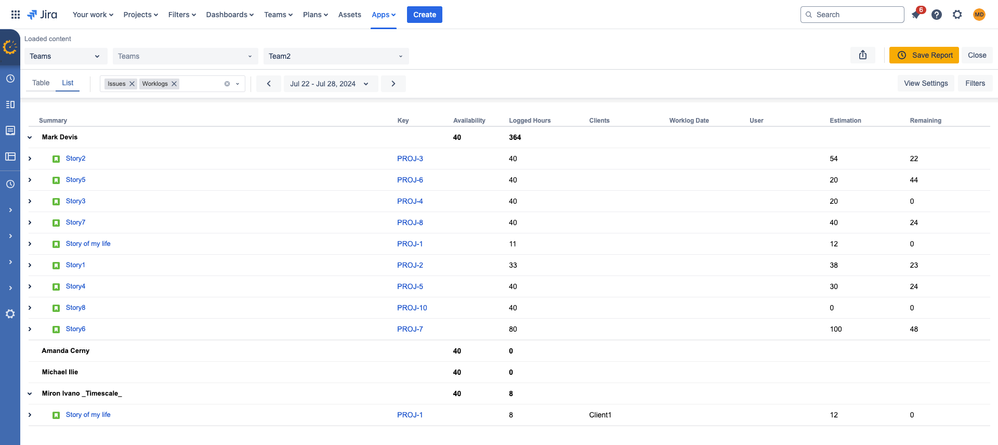

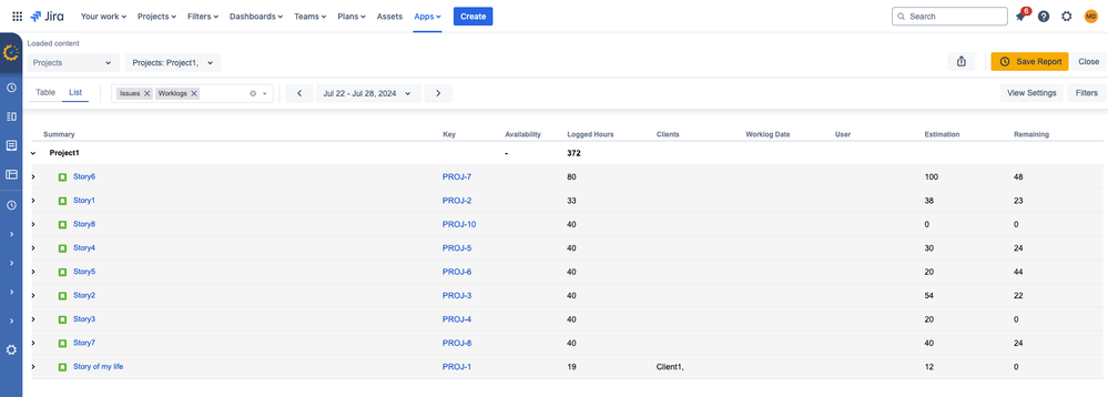

There many time tracking app that can do what you need. They have customisable reports. Many organization want to track these two indicators mainly to asses their teams estimation accuracy. There are teams that even have actual KPI's on those indicators. Still at the end is a question if you have this information does it give you extra tools to improve your teams performance?
Still what you can check is: Timescale for JIRA.
You can see the comparison on Projects Level or on User Level. I think soon there will be on Sprint level
Screen Shot 2024-07-24 at 13.56.59.pngScreen Shot 2024-07-24 at 13.59.15.png
You can always contact Timescale
