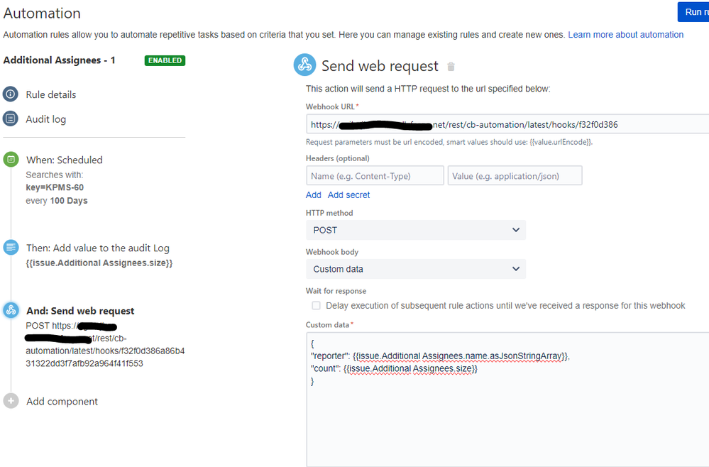

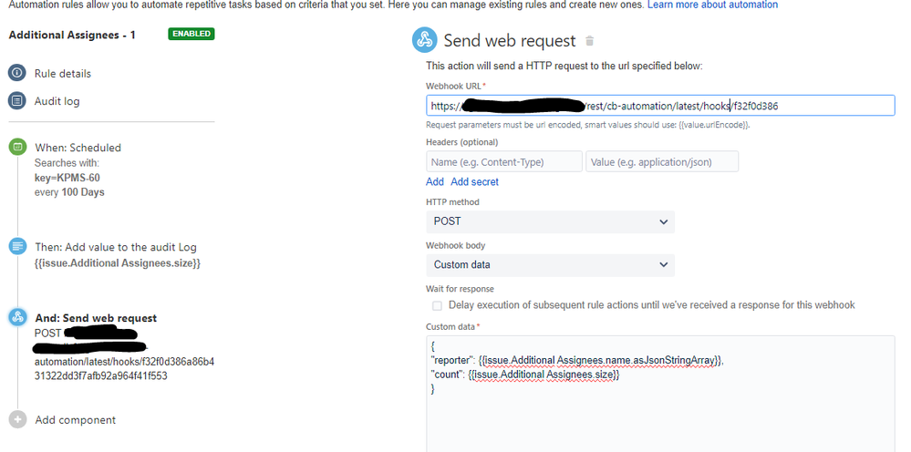

Now we set up Rule #1:
NOTE: I am testing with "Additional Assignees" field in my test. You should replace this everywhere below with the actual field from your Jira instance. Maybe its customfield_11700, I dont know. So please change that accordingly.
  • Trigger = Scheduled with JQL = ABC-123 .. (give 1 sample issue key for test purposes.)
  • Action = Log Action => {{issue.Additional Assignees}}    <-- you are logging your reporters. Again change it to your actual field.
  • Action = Log Action => {{issue.Additional Assignees.size}}    <-- you are logging how many were selected.
  • Action = Send Web Request =>
    • Give URL from rule #2 you copied earlier
    • HTTP Method = POST
    • Webhook Body = Custom
    • Custom Data = Below JSON:
      "reporter": {{issue.Additional Assignees.name.asJsonStringArray}},
      "count": {{issue.Additional Assignees.size}}
Basically we are sending list of users and their count to rule #2 here in the payload. reporter is formatted as array and count is a number. Thats it. This ends rule # 1.
Now, We do sanity check and test the set up.
  • As mentioned, In Rule # 1, in Trigger, in JQL section, give an issue key where this multiuser field is populated with more than 1 user.
  • And click Run in Rule # 1. Then when it has run successfully,
  • when you look into Rule #2 audit log, it should show the payload we sent.
If you see this, we continue completing our Rule #2. If you dont see this, you need to stop and investigate. Maybe you need to tweak your customfield smart value. So if {{issue.customefield_11770}} does not work, try {{issue.customefield_11770.value}}
Continue next only after you are seeing the payload properly in Rule 2 audit log.

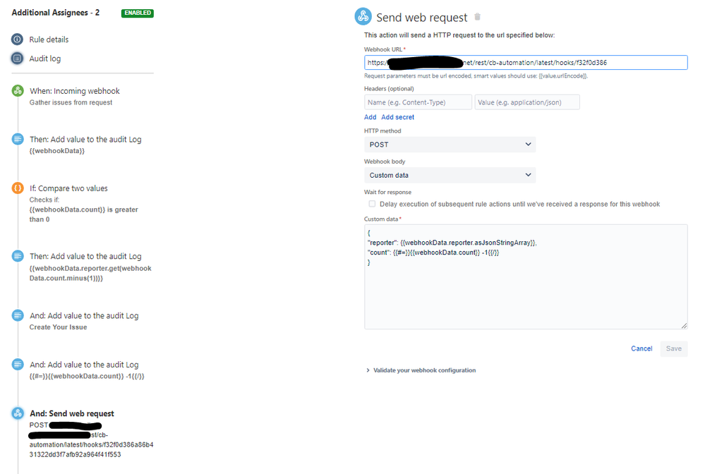

Completing Rule #2:
We continue where we left off earlier where we set up trigger and put in log statement. So our complete steps then are:
  • Trigger = Incoming webhook,    <-- Dont need to change anything else on this screen.
  • Action = Log Action => {{webhookData}}
  • if Condition -> Compare smart values =>
    • {{webhookData.count}}
    • Greater Than
    • 0
  • Action = Log Action => {{webhookData.reporter.get(webhookData.count.minus(1))}}
  • Action = Create Issue (like you normally would) where above smart value gives you the reporter you can assign in your newly created issue.
  • Action - Send Web Request
    • Give same URL of this rule.
      "reporter": {{webhookData.reporter.asJsonStringArray}},
      "count": {{#=}}{{webhookData.count}} -1{{/}}
This completes your rule #2.
Explanation: In this Rule, we are looking at "count" value in payload.
If Count is > 0, we will create issue by choosing reporter.get(count) and once we have created it, we decrement the count and call the webhook again.

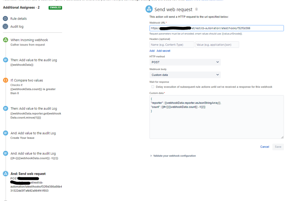

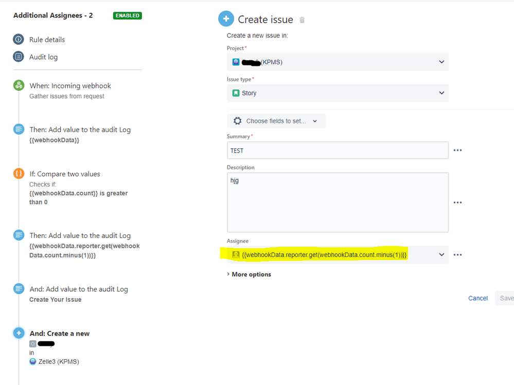

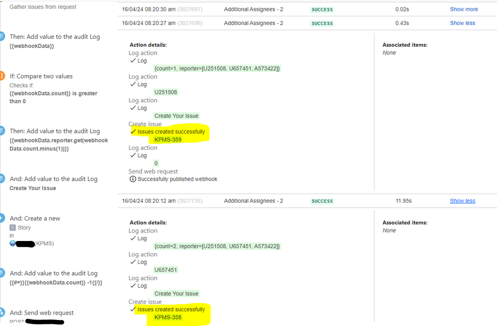

Screenshot of Rule #1
Screenshot of Rule #2

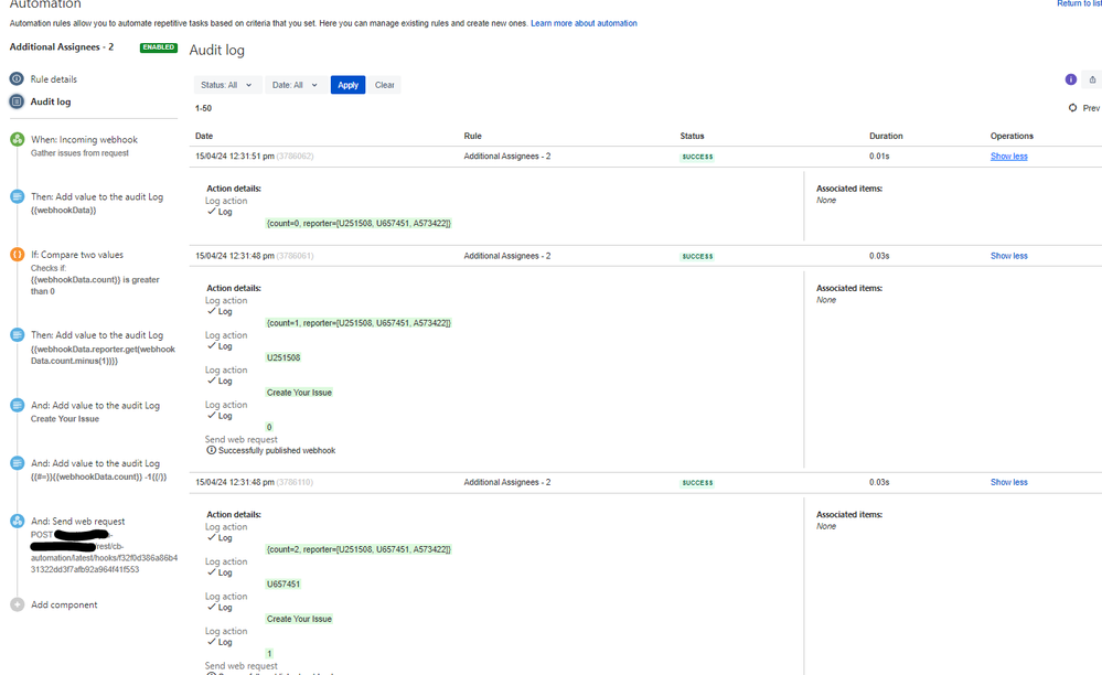

Screenshot of Audit Log of Rule #2
As you can see from Audit log, rule recursively calls itself until count = 0, when it then exits and completes the job.

Kalyan Sattaluri
April 15, 2024
Screenshot of Rule #2 Audit Log

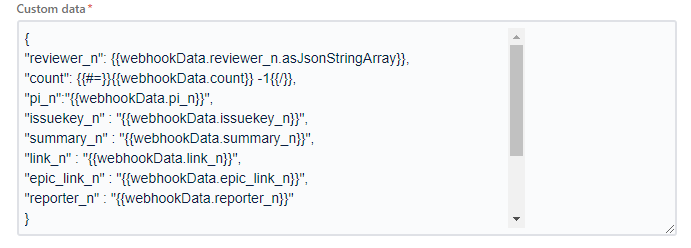

Tom Scoggin
April 16, 2024
@Kalyan Sattaluri
Sorry I didn't see this yesterday. I was head down trying to get the other solution to work. Did this solution create 3 new tickets for you?
Kalyan Sattaluri
April 16, 2024
Yes, I wouldnt have written above thesis if I hadnt tried it...lol.
If you specify the project and issue type when creating issues, it does create. Please see scree shots:
Rule #2

Tom Scoggin
April 16, 2024
@Kalyan Sattaluri
Well some success. I can create tickets but I can't add any other fields form the original ticket to the created tickets. Well other than adding the reviewers as an assignee now.
You can see here that I can pull other data from the ticket and add it to the log but if I try and add any of it to the Whenever I add anything to the Post it gives me an error 500.
When I try to add any of these fields to the Post (like below) it just doesn't work. That's when I get an error 500. Any thoughts about why I can't pass any other fields along to the second automation? I tried with _ and without. I tried differrent fields. Didn't make a difference. The only success was to only use the first two lines of code.
Kalyan Sattaluri
April 16, 2024
You need to wrap string in quotes for valid JSON..
For example, if I wanted to pass trigger key, trigger description over to rule #2 as well, I would use below JSON. If JSON is not formatted correctly, it will give you 500 error..
"count": {{issue.Additional Assignees.size}},
"issuekey" : "{{issue.key}}",
"description" : "{{issue.assignee}}"
Tom Scoggin
April 16, 2024
@Kalyan Sattaluri
Well I was wondering about that. I've been watching videos about Json and that's what they said. I just didn't put the smart values in the same relm as strings.
It worked once I did that. Thank you for all the help.

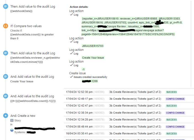

@Kalyan Sattaluri  My system is only creating one ticket instead of two or three. Are you creating your tickets with a Post or Create Issue.
Kalyan Sattaluri
April 17, 2024
I used normal "Create action" to create issues. What is your audit log showing?
Tom Scoggin
April 17, 2024
Rule 1 Log shows a count of 4
From Log 2
Kalyan Sattaluri
April 17, 2024
You have a typo.
Should be -> {{#=}}{{webhookData.count}} -1{{/}}
Instead it is {{#=}}{{webhoodData.count}} -1{{/}} , which evaluates to -1 and is exiting the loop.
Update it in your log statement and also the last step where you are calling the same ruel again.
Tom Scoggin
April 17, 2024
@Kalyan Sattaluri
Well, a couple of things.
I missed the step of doing a Send web request at the end of the second automation. Hard to do a loop without that!!
Then because I was using a lot more data fields I had to customize that web request as shown below to capture and resend the data for the next ticket.
But it looks like it's working now.

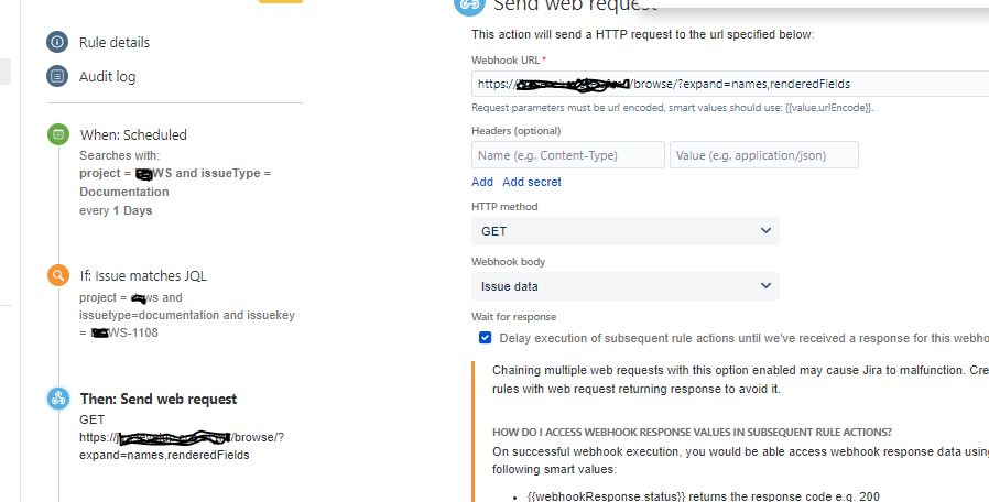

This is my first attempt at using Web Requests. When I test my Send Web Request and give it a ticket number it returns the correct information. I'm not familiure with List Iteration. Where is that?
I think the smart value I will need is to create the new tickets is {{webhookResponse.customfield_10192.username}}. This is the response for Reviewer(s).
Bill Sheboy
March 27, 2024
Here is the documentation examples of iterating over lists: https://confluence.atlassian.com/automation/jira-smart-values-lists-993924868.html#Jirasmartvalueslists-examplesExamples
For your rule, you would iterate over the field values, adding the necessary JSON to create the issue.  Example pseudocode of that would be:

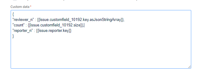

Tom Scoggin
April 11, 2024
@Bill Sheboy  I'm back working on this. I was able to create a Webhook and then get a list of Reviewer(s) and add them in the Audit Log. I'm trying now to create Story tickets.
I'm assuming I do it using the Create Issue plugin and then add my json under the Additional fields section.
I'm using this in the Create Issue Summary field - Review {{webhookResponses.body.fields.summary}}
When I try it now it's saying invalid json. Here is the code I'm using in the Additional fields section
{{#issue.customfield_10192}}
"fields": {
"customfield_11700": "{{webhookResponse.body.fields.customfield_11700.value}}"
"issuelinks": [
"type": {
"id": "10003"
"inwardIssue": {
"key": "{{webhookResponses.body.fields.issuelinks.inwardIssues.key}}"

April 11, 2024
using this and still get "Error while parsing additional fields. Not valid JSON." I also have another version that was only saying that the project and issuetype were not set. Not sure if you want to see that one.
"fields": {
"customfield_11700": "{{webhookResponse.body.fields.customfield_11700.value}}",
"issuelinks": [
"type": {
"id": "10003"
"inwardIssue": {
"assignee" : {
"key" : "{{webhookResponses.body.fields.assignee.key}}"
"issuetype" : {
"id" : "10001"
"customfield_10101": "{{webhookResponses.body.fields.customfield_10101}}",
"creator" : {
"key": "{{webhookResponses.body.fields.creator.key}}"
"reporter" : {
"key" : "{{webhookResponses.body.fields.reporter.key}}"
"customfield_11340": "{{webhookResponses.body.fields.customfield_11340}}",
"description": "*Definition of Done:*\r\n\r\nThe assigned Reviewer has reviewed """{{webhookResponses.body.fields.summary}}""" and worked with the author to correct any concerns.",
"priority": "10000"

Short version: my apologies, as I gave you an incorrect direction to solve this one.
You are using Jira Data Center, and that does not have an advanced branch feature for rules yet, as noted earlier by @Kalyan Sattaluri.  And...
Once inside of an iterator, no data from outside that scope is visible.  And so once the iterator starts for the {{issue.customfield_10192}}, no data from the {{webhookResponses}} will be visible.
At this time, the only ways I can think of to do this in a rule are:
  1. when there is a known, defined list of possible reviewers, use a list of if / else conditions to add them
  2. complicated use of variables to build the JSON dynamically using inline iteration
To clarify that second one, which I have not tested, the idea is:
  • identify the JSON needed to add one issue, noting where the value from the custom field selections would be used (if needed)
"update": {},
"fields": {
"project": {
"id": "1000"
"summary": "a summary",
"issuetype": {
"id": "10000"
"assignee": {
"name": "value from custom field selection"
  • split that JSON into two parts: the part before the selection / user and the part after
  • store each part in a created variable, named varJsonPrefix and varJsonSuffix, respectively.  Ensure the suffix has an extra trailing comma at the end to handle multiple issue boundaries.
  • create a single JSON expression which spans all of the selected users in the field, using an in-line iterator and text functions, storing that in a variable named varIssueJson.  Please confirm the attribute for the custom field, as I am not using Jira Data Center.
{{issue.customfield_10192.name.join("~~").split("~~").replaceAll("(.+)",varJsonPrefix.concat("$1").concat(varJsonSuffix)).substringBeforeLast(",")}}
  • How that works...
    • join together all of the selected users, with the known delimiter ~~
    • split them back apart into a list
    • use the replaceAll() function with a regular expression
    • to assemble the pieces together for the JSON
  • finally, add the wrapper JSON for the bulk add function
"issueUpdates": [
{{varIssueJson}}
UPDATE: After testing some of this logic, I changed the regular expression from zero-to-many to one-to-many to prevent empty entries after the split() function.
Tom Scoggin
April 12, 2024
Wow @Bill Sheboy this is a lot for me. It will take me some time to work through this information. Like I said, this is my first go round with using rest api. It makes sence but it will take me some time to get it to work. OJT, LOL.
I will post here with additional questions as they come up.
Thank you for taking time to work this issue with me.

Tom Scoggin
April 15, 2024
@Bill Sheboy
Couldn't the varJsonPrefix and varJsonSuffix be combined into a single object and then in the varIssueJson only add the one object to the variable? Learning as I go. LOL
First and second var is below. The "reporter" field needs to capture the user's key value from field customfield_10192.
var varJsonPrefix = {
"fields": {
"customfield_11700": {
"id" : "{{webhookResponses.body.fields.get(0).customfield_11700.id}}"
"project": {
"id": "12804"
"issuelinks": [
"type": {
"id": "10003"
"inwardIssue": {
"key": "{{triggerIssue.id}}"
"assignee" : {
"key" : "{{webhookResponses.body.fields.get(0).assignee.key}}"
"issuetype": {
"id": "10001"
"summary": "DCO Lead Systems Engineer Review of Service Asset Configuration Management Process"
var varJsonSuffix = {
"fields": {
"customfield_11340": "{{webhookResponses.body.fields.get(0).customfield_11340}}",
"description": "*Definition of Done:*\r\n\r\nThe assigned Reviewer has reviewed {{webhookResponses.body.fields.summary}} and worked with the author to correct any concerns."
var varIssueJson = {
"issueUpdates": [
{{varIssueJson}}
Bill Sheboy
April 15, 2024
I do not think so, and would recommend writing the constructed JSON to the audit log to check that approach prior to calling the REST API.
My suggestion was based on some assumptions...
  • there is a multiple select, user field
  • there is a need to create one issue per selection
  • with each value from the user field set to a field in the new issue (e.g., assignee)
If any of those assumptions are different, please let me know.
My suggestion was to split the JSON to the left / right of where the user value would be added to the JSON, allowing creation of a complete issue's JSON for each one.
