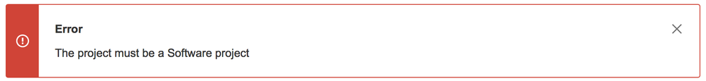

Jira Service Desk does not actually have Kanban/Scrum boards, but you can configure a kanban/scrum board to show service desk tickets. But please note, it has some restrictions, will not work as software projects do. You also need to have Jira Software for it.
Since Service Desk does not contain boards, this isn't exactly how it was designed for Agents to work on issues. You can still do it following the steps below, however, to have these users each using Service Desk and a Kanban board, each user will have a license for both applications (Jira Software and Jira Service Desk). With Service Desk Agents are typically more focused on using queues.
To create a board with service desk projects, please follow the steps below:
After that, to add the board to the service desk view, you can "Add a link" on the "Project Shortcut".
Also, please refer to the following documentation, where it recommends other solutions:
JIRA Service Desk (JSD) does not ship with a boards function, as it's unusual to manage service requests in this way. But, if you also buy JIRA Software, you can get Kanban board functionality and apply it to JIRA Service Desk projects.

I cannot find the option to create a board anywhere in my instance.
I am using JIRA Service Desk, but do not have JIRA Software.
Is it possible to configure a board to organize issues as they are coming into projects from the Service Desk portal or email submission? We've also set up a generic intake project that we were thinking of configuring for some issues that the user was unsure where to assign the issue.
Thank you for your assistance
Danny,
Boards are not available in JSD standalone, you need to have Jira Software installed as well.
