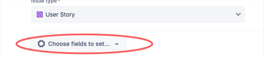

I am working on automation to create an issue in a project with the mandatory "Team" field, when some workflow transition happens in another project. The project field doesn't show on the list of the available fields in "Choose fields..." drop-down:
Is there another option (JSON?) to do so, similar to a cascading select list? I'd greatly appreciate community's help. Please let me know if you have any questions.

I've tried it without [ ] and with the "field" syntax as well as setting up a Log Action. The {{customfield_13600}} came back empty, while it brought corresponding value when I used it for another "regular" field. My guess is the "Team" field acts differently from other fields and I'd need to wait for Atlassian to fulfill a long promised change to this field. Unless someone could prove me wrong, which I'd gladly accept.

What is the output in the Audit Log for the rule when it executes?
Have you tried adding Log Actions to output the value of the custom fields before and after the update, for each issue?
From this post it looks like you need to use the numeric ID associated with the Team when setting the field. If you use the Log Action action to log the values to the audit log, you'll be able to confirm that you are getting the Team ID from the original field.

Oh, and the log file tells me that the automation didn't work because the "Team" field is mandatory, which means that my JSON either doesn't work (incorrect), or wouldn't work at all with the "Team" field.
