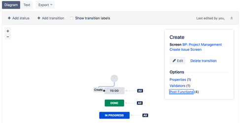

- Navigate to your project > Project Settings > Workflow > Click to Edit the relevant workflow
- On Diagram Mode, click in the Create transition of the workflow > Click on Post Functions:

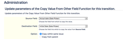

- Click to Add Post function > Select the Copy Value From Other Field, configuring it to copy the value from Actual date in the Initial Date:
- Save the workflow draft

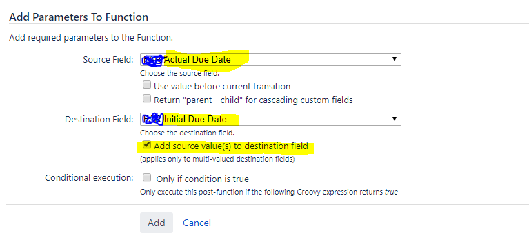

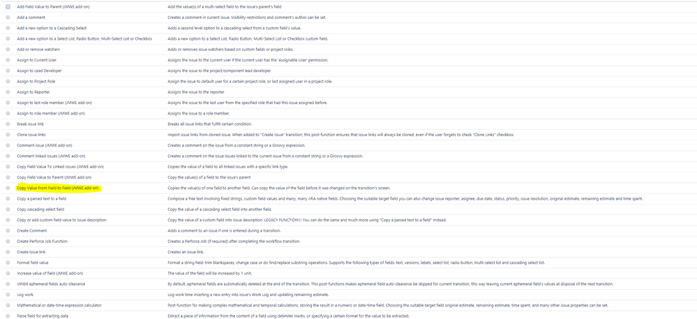

Hi, I tried the same steps hopefully.
I made changes in the workflow added a post function and than publish workflow and its was linked to the project.
I hope its correct but it is not working for me or i missed something
And additionally one more thing how can i add a counter so everytime the date changes counter is set from 0-1-2....Capture.PNGCapture1.PNG
